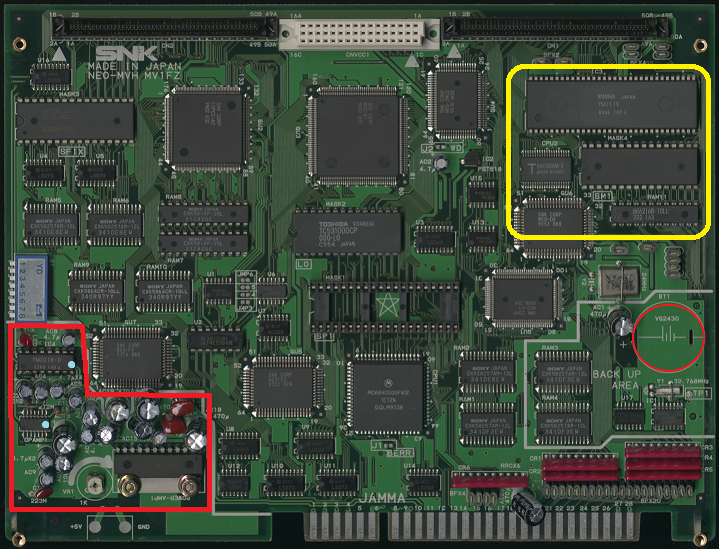

As yavuzg said you should check that things ... but if you're getting humming/hissing going louder/softer when you turn the volume up/down with the pot the power amp HA13001 should to its work, by the way you already replaced it and the audio issue is still there.
if something in the digital part of the audio circuit was bad the startup test should rise at least a Z80 error, so you should focus on the analog section of the circuit.
Look at the attached picture, the ICs in the yellow square are the DIGITAL part of the circuit, you should check the ANALOG part the RED bordered one.
The audio chain is the following:
(DIGITAL) Z80/YM2610 > DAC YM3016 (DIGITAL-ANALOG CONVERTER) > OPAMP uPC844g > POWER AMP HA13001 > JAMMA
So you should check the DAC and the OPAMP, they are light-blue dotted.
