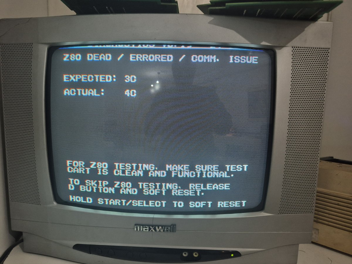

Hello,
My MF1z plays games fine, except for sound when starting the playgame. Menu is ok, character select is ok, but when after selection i can hear the starting neogeo logo. In addition starting the level will stop the music and sounds. Exactly at the same position every time.
I got with diag rom and cart the exact same error everytime. z80 dead.
Excpexted :3C
Actual:4C
Tested all continuity between Z80, Ym2610, Sm1, D0, C1 and cart port pins.
Changed z80 anyway, 6116 and checked the sm1 rom. No change.
1 year ago, Board already recapped, a0 amp changed and battery removed. Worked like a charme
What to see next?

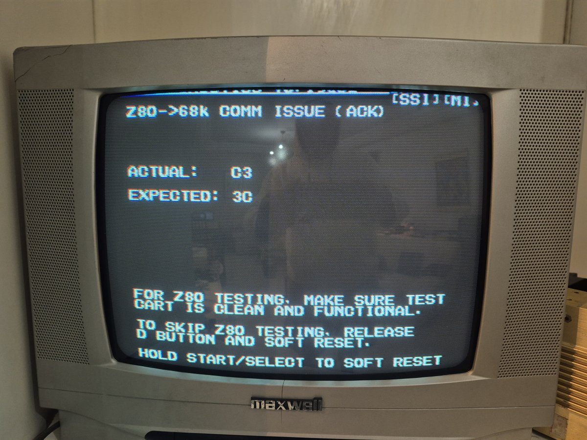

I Made a new burn with the link you shared, and i got this message (same prrrt sound, and 001100 beep) only thing changed is "excpected" is 3C. Was 4C before.
Checked also all continuity you mentionned. All ok.

Your picture implies the path from m1 -> diag is working ok because diag bios got the 0xc3/HELLO message and sent back the 0x5a/HANDSHAKE to the diag m1. However it would appear the diag m1 never got that message. The sound latch (in the NEO-C1) should get updated when the 68k writes a byte to address 0x320000. I would try checking the following on the NEO-C1
A17-A21 should go to the 68k cpu
A22I-A23I devwiki says those go to a NEO-E0
R/W, UDS, LDS, AS, DTACK should go to the 68k cpu
On the NEO-E0
https://wiki.neogeodev.org/index.php?title=NEO-E0
A22-A23 should go to the 68k cpu
Its of course possible you have a faulty NEO-C1 or something else.

Just rechecked all of that.. all connections are like described..
Not sure how to feel about it lol.
