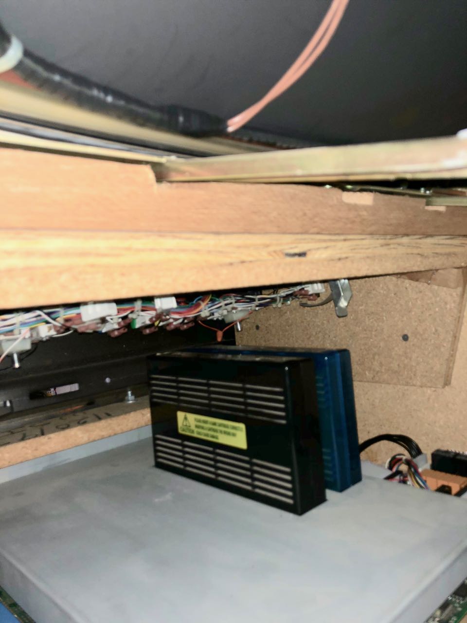

So after hitting it with the degaussing coil, I can no longer detect anything out of place with the gaussmeter. So, guess it was just the monitor frame after all... still having issues with the consoler cable bundle hitting some carts. Seems that a few of mine (which may be in after market shells) are slightly larger and hit something. Will have to bust out the endoscope to figure out what's hitting what.

So looking into the other issue, of something hitting the carts when the panel is closed... It's not the wiring bundle. I frankly can't see ANYTHING making contact. If I had to guess, it's the metal tray where the PCMCIA and headphone board would mount for a 4-6 slot board.
