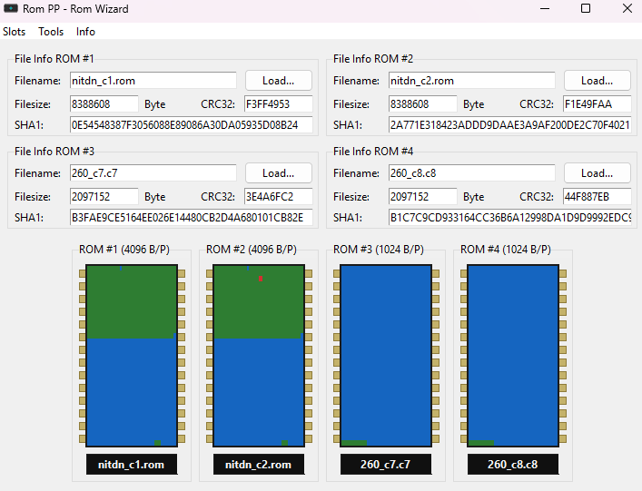

one thing I remember was that this game becomes very slow, who knows if an optimization like metal slug 2 is possible
Looking at the 8 MB of c sprite decrypted you can see that the last 4 MB are practically empty.

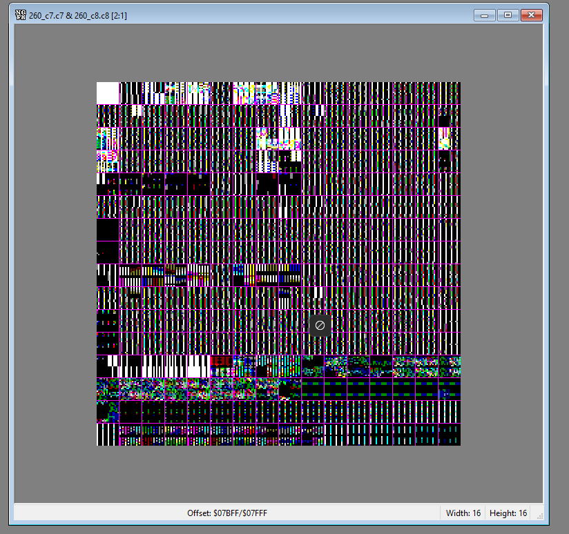

looking at the sprites written at the end you can see this:
they don't seem like coherent sprites, they could be the result of the decryption process and not used sprites, the game also works with the first 4MB of C1 and C2.
