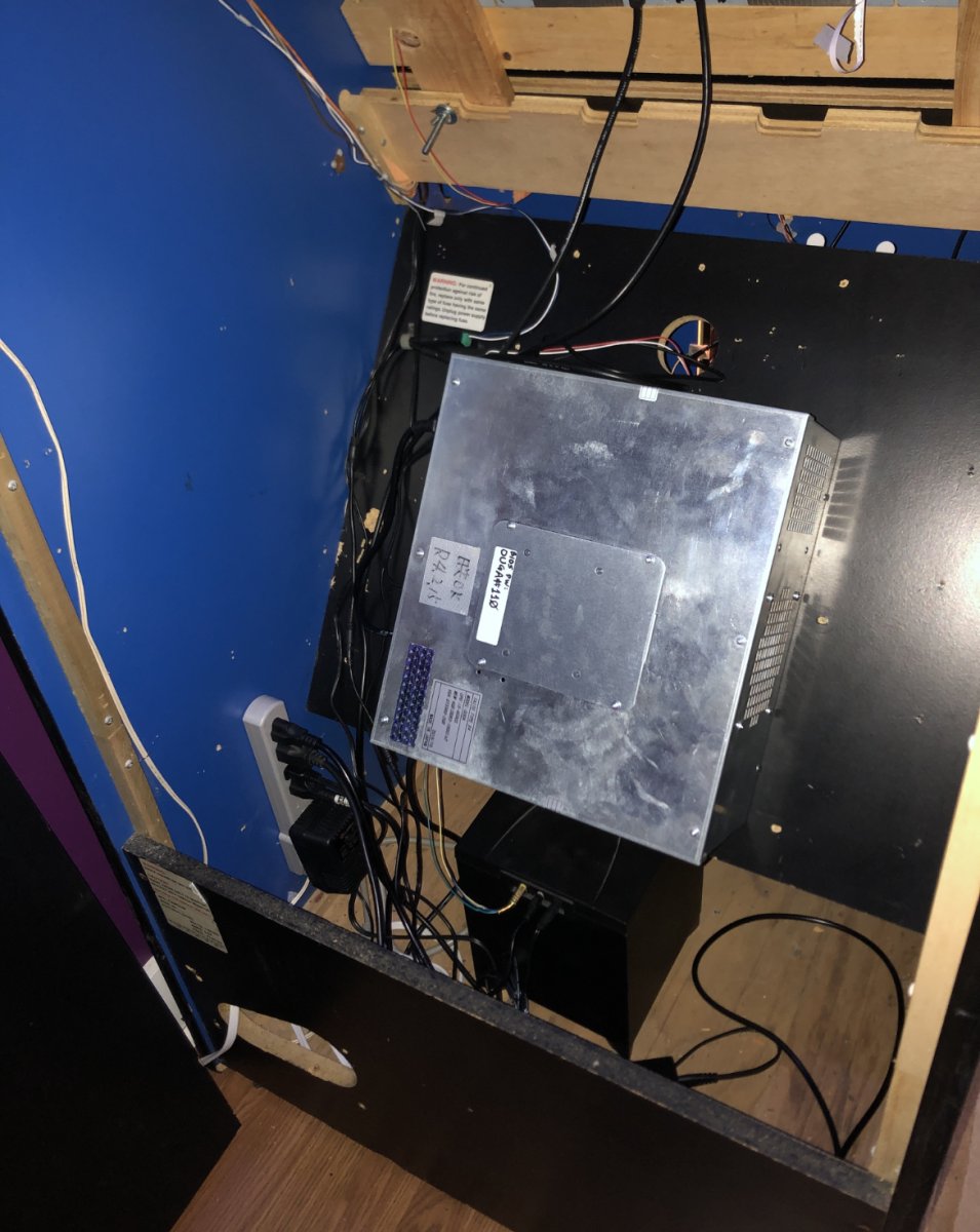

Is your subwoofer sitting on the base of the cabinet with the speaker pointed towards the front panel, set back from the coin door? Trying to get some ideas where I'd squeeze one in while protecting the rest of the equipment.
Original cabs have enough space for a subwoofer under the PCB support shelf. The cabs didn’t come with one originally afaik, but it makes modern titles sound a lot better.
Yes it is I built this one though styled on the big blue cab, the big blue never came with a sub but it makes a hell of difference to the sound.
