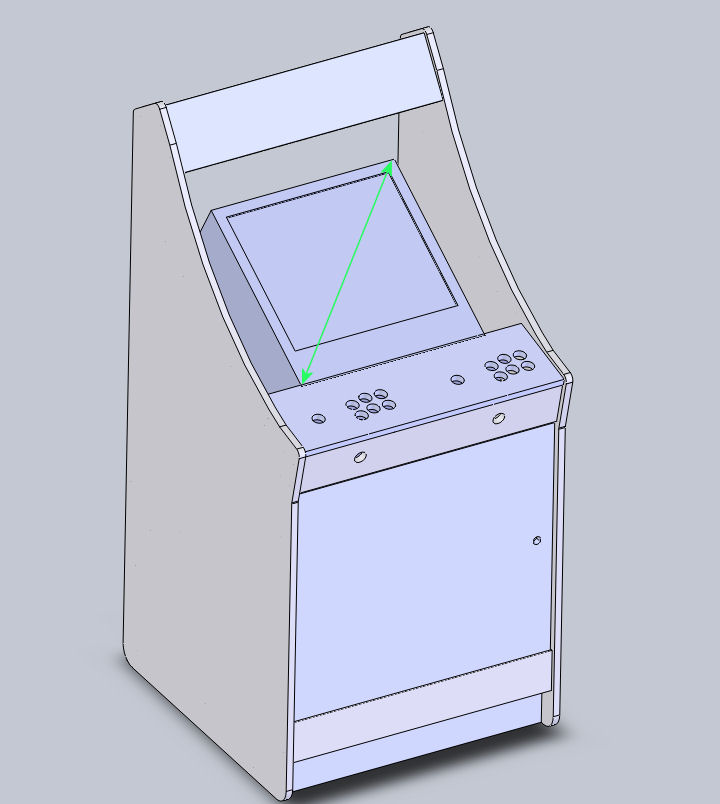

very nice work @andre060 I really like the idea of using a regular TV instead of an arcade monitor. I wanted something like this but in a lowboy - so a really good guy called Rob over at arcadeworx helped me to put together this little lowey, which fits a 20" Sony PVM and allows the monitor to be rotate 90 degrees for horizontal or vertical games (it could be a consumer TV so long as it fits). Its being cut next week, and will be fitted out with a decent sound system (not as amazing as yours) and seimitsu/sanwa stuff.
