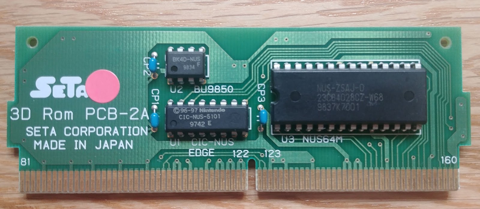

The Mahjong carts have some extra IO hardware on the cart but the simpler Aleck64 carts look like this:
by comparison here's a pic of an N64 Mario Kart PCB:
both carts are essentially just the Serial ROM, security chip, and save chip
