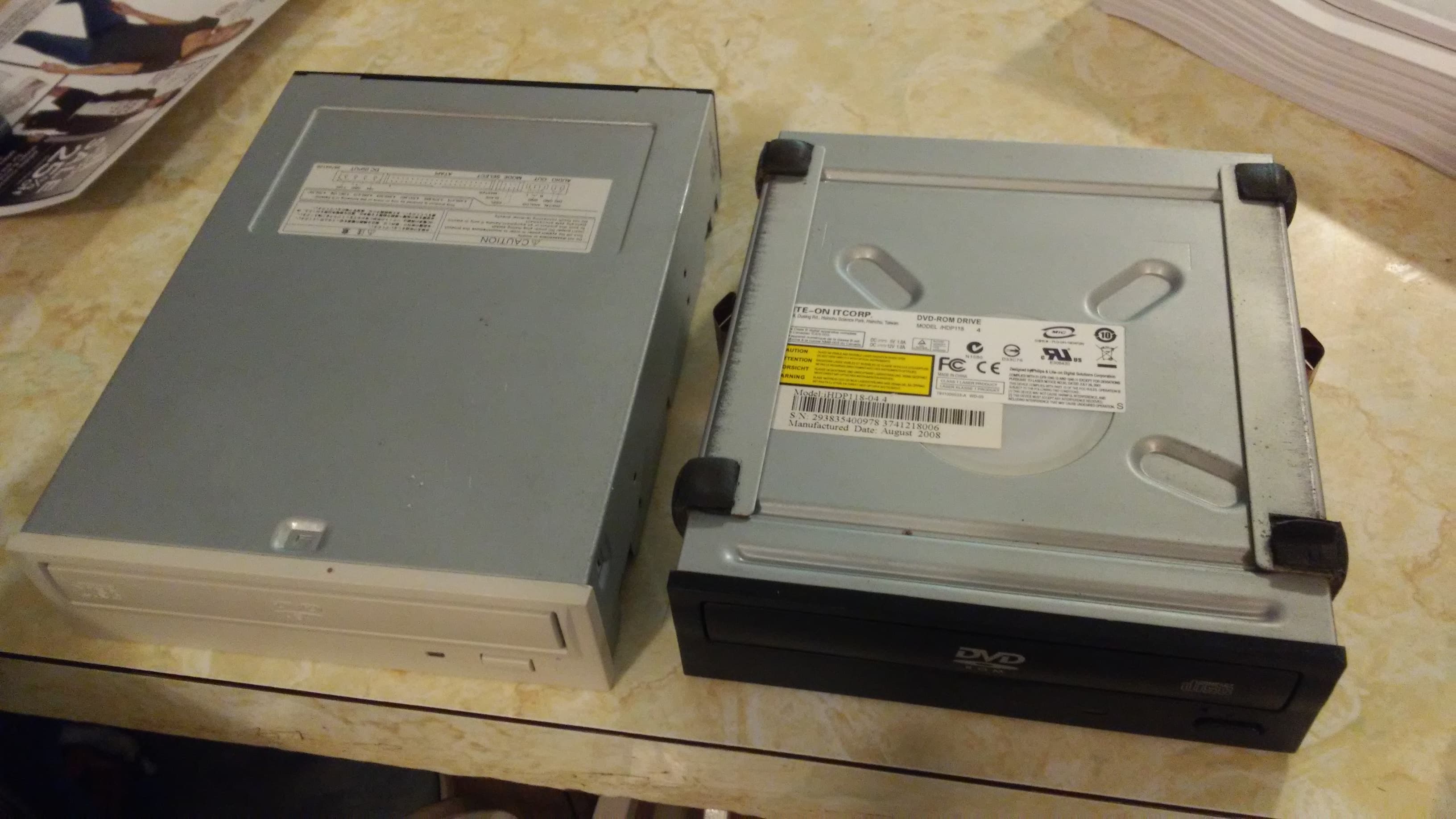

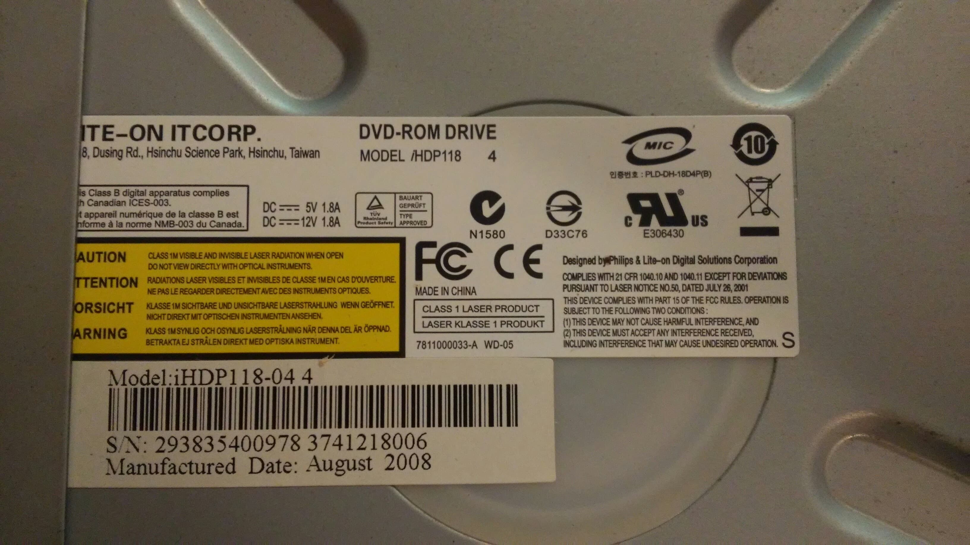

The original drive that was in it was a Lite-On It: iHDP118.

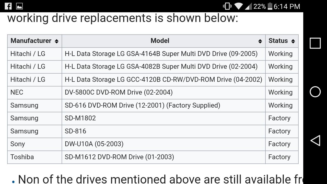

Replacement drive I bought (which i thought was on the suggested list) is a Toshiba SD-M1712. Looking now i think it was supposed to be a 1612... Not a 1712. Hmm..
I did find another drive on eBay that seems to be on the compatability list..

New IDE cable and 2 more different suggested disk drives later, still no luck.

Already tried that. Drive powers fine from atx as long as ribbon is unplugged. But wont turn on otherwise. Tried 3 different drives and 2 different ribbons. One you suggested was new.

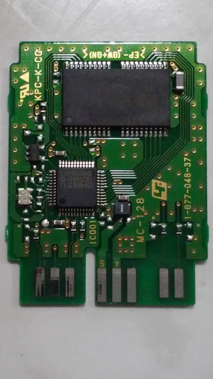

Take the 2 screws out of the dongle and remove the cover (It opens like a ps 2 memory card so you can google it)
No matter how clean the pins look on the dongle. Use a pencil eraser on it to clean the pins , wipe them down with some alcohol on a qtip, then use some contact cleaner on a qtip to go over the pins. Wipe off the excess cleaner with the other side of the qtip, insert, and try again.

I buy "non-working" dongles all the time. They usually work after taking them apart and cleaning the contacts with a dab of brasso. They are usually filthy. Alcohol is cool but not great .

Heres the SC3 dongle. Cleaned again with an eraser.

Went one step ahead, re-cleaned and polished the pins and now it has a mirror reflection. lol
You can see my camera's reflection in this picture. :D
Unfortunately, it's new beauty hasn't changed the outcome. Still dead. Still gotta wait a couple weeks fort the Gundam Game and dongle I ordered to arrive to know for sure if it's just the game or the system.

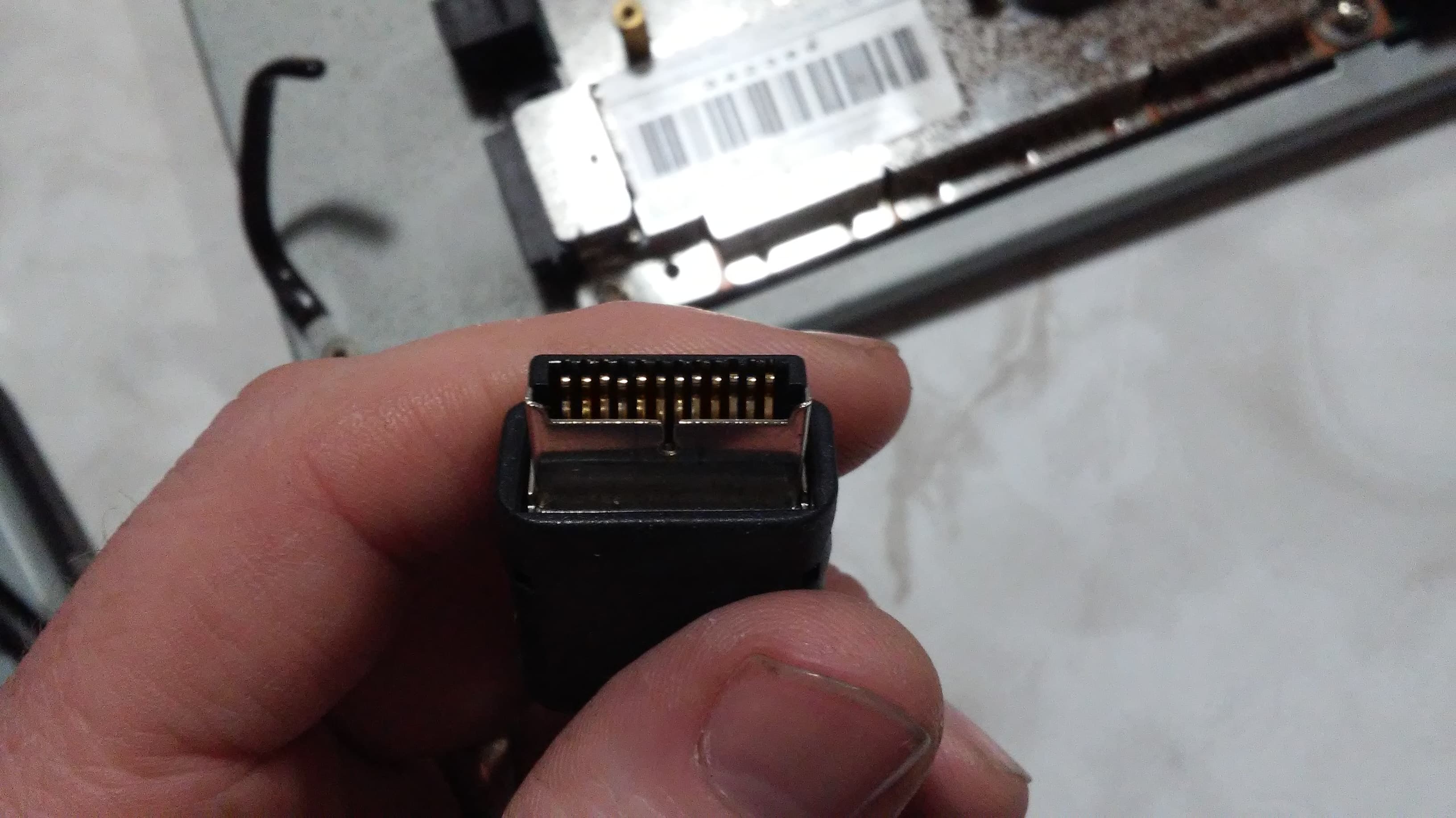

The other thing to check is that the connector that look like the playstation av black connectors and are connected to 2 points of the system, should have a shiny outer grounding shield as well. If they are dull you will also get no video or working system.
Remove the cables and polish up the outside silver metal casing like you did with the memory card and then reinsert and try again to see if things change .
Alright, the AV cables have all been thoroughly cleaned and polished.

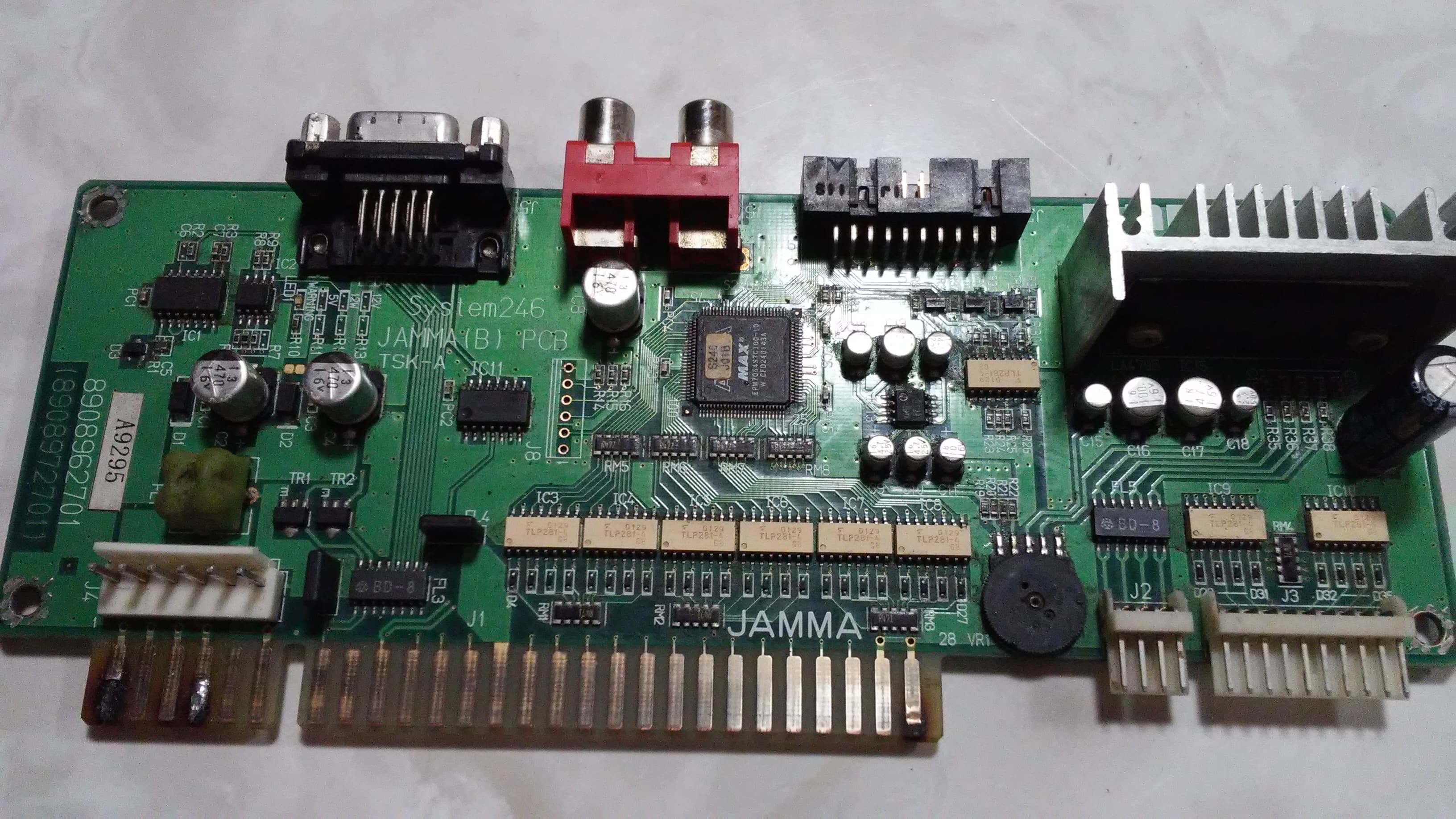

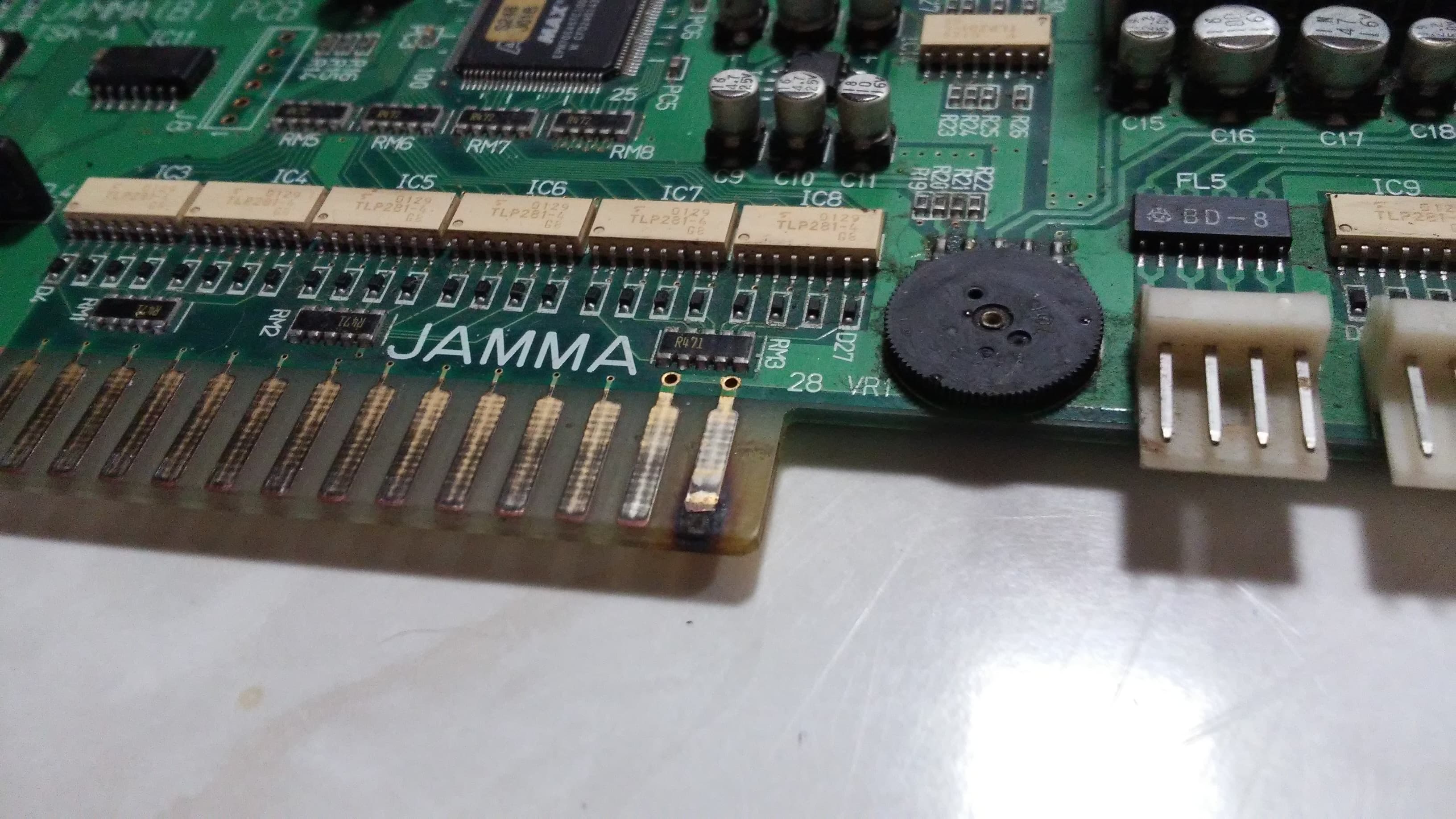

Lastly, I started re-looking at my I/O board and came across more concerns. Some of the pins are becoming charred. This board has now been polished and since the finger on the left is so damaged, i soldered on a new line to this pin around the jamma harness. Was hoping that was the fix.. But it wasnt. :thumbdown:

The ground pins are charred which is definitely a concern since that means enough voltage is getting to the ground pins on the connector to cause that. Not good.
I'd very much be questioning that power supply and your cab wiring if you're sure you're plugging it in the right way.

I have since replaced the Namco Jamma B I/O Board. Found a "working" one on Ebay. I have also replaced the Power supply as I was told the standard cheap "Screw" style are not good for this setup. I switched it out with a known working box style from my Lethal Enforcers cabinet.
After replacing the I/O board and the power supply, I am literally at the same point I was before. Everything has power and voltage, but the system won't boot. No tones, no dvd drive activity, nothing... well except for the fan spinning on the back of the Namco 246. The I/O board shows solid Green LED by Warning text, but nothing else.
