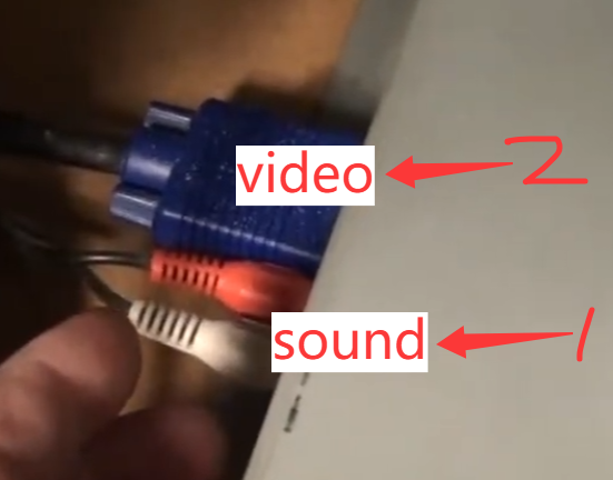

I've tried a few different monitors/settings and one odd behavior is the Dell monitor I tried to se d VGA signal directly to keeps trying to auto adjust. Not sure if that means the 246 is sending and stopping over and over or what.
