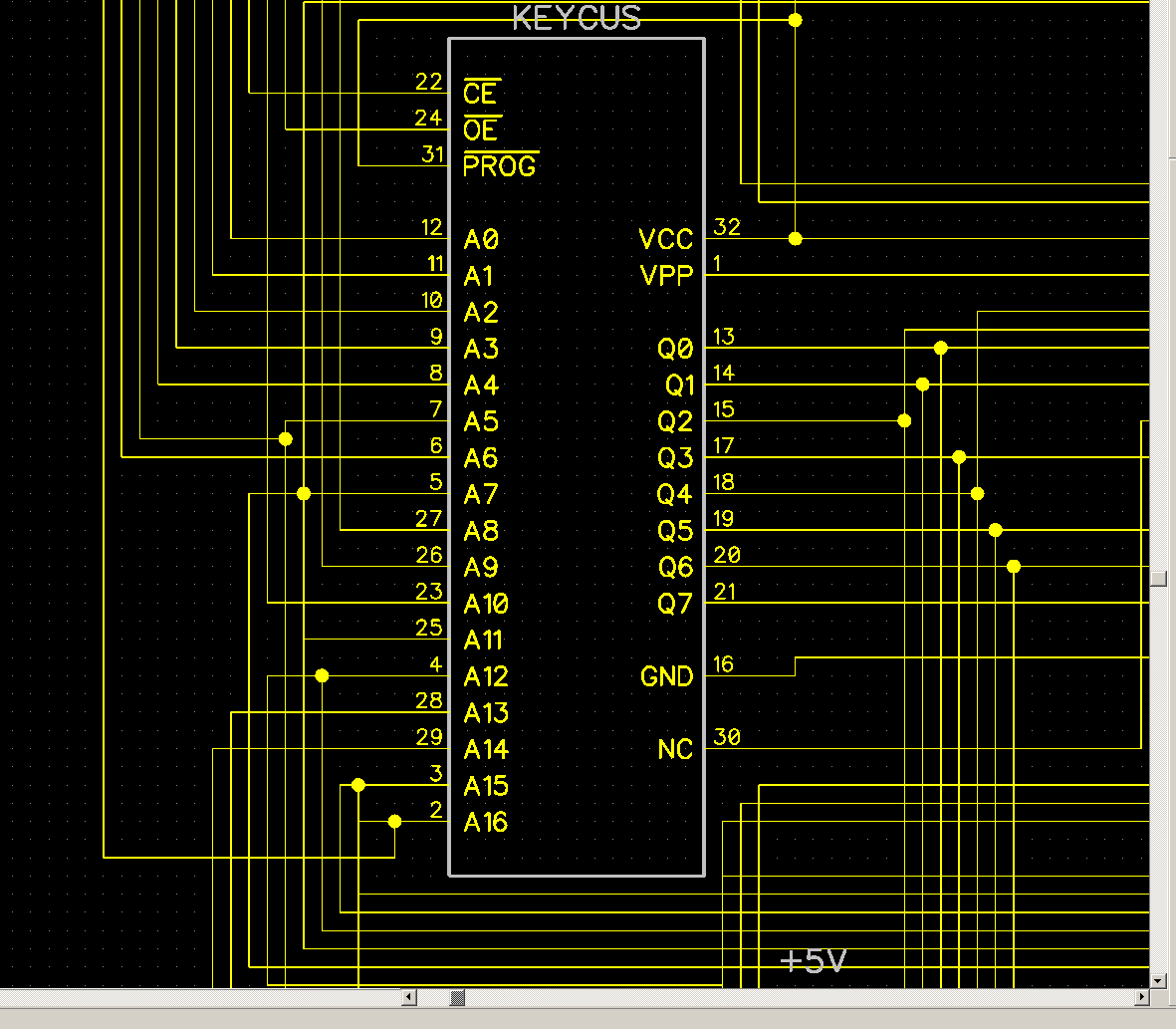

Anyways a small update for this one as the post exists now, long boards etc have arrived but not collected them yet.
Board layout ticking along slowly. Working out the EEPROM / ram now so we can have settings and high score for each game saved.
This project is not dead don't worry :)
The long boards arrived, and there is nothing special going on with them.
The board layout is very close, just need to work out the rom type to use and set it up accordingly.
The games are high in meg so rom choice will be the main 'cost' of the board... so must think carefully.
Here is a teaser pic of the keycus section of the board layout, things are progressing but not fast :)
(i don't think it will be finished this year...)
