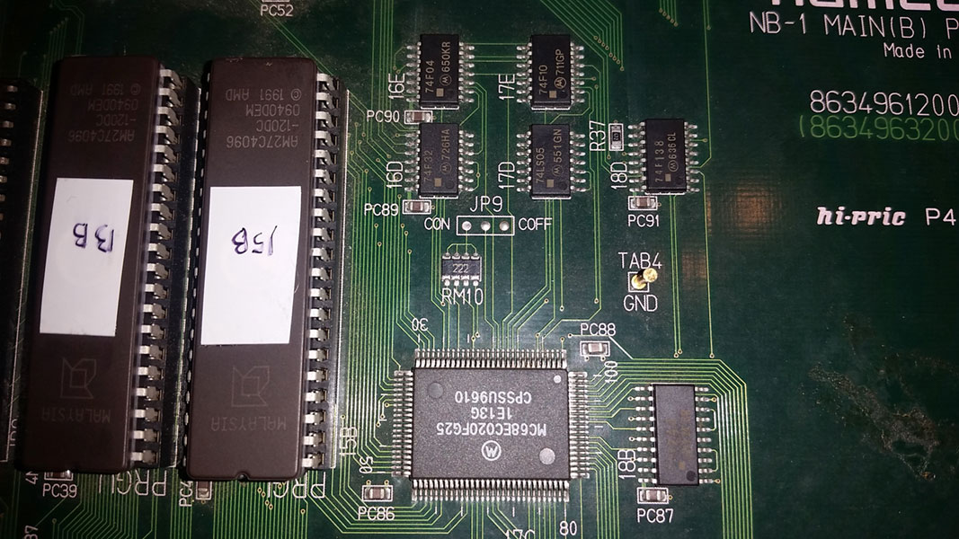

the only jumpers that seem to do anything with the CPU are 9, 10, and 11.
JP10 and JP11 are near an unpopulated 28MHz OSC position and seem to be designed to change the clock speed
JP9 is a 2 position jumper labeled "CON" and "COFF" and has a permanent trace trace connecting CON to the center pint
The right pin is tied to ground,
The center pin of this jumper goes to Pin 15 on the MC68EC020 "SCKR"
the left pin goes to a 222 Resistor network, the outputs of which go to
-pin 22 on the MC68EC020 (HRW/HRD)
-pin 19 and pin 1 on the MC68EC020 (GNDQ and SCK/SCL)
-nothing
-the unpopulated J104 connector (but populated on Point Blank for the gun board)
Here's a photo of that area:
