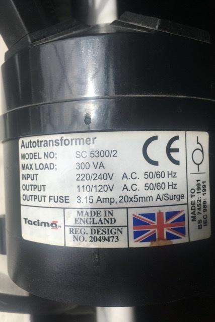

Hiya, just received my noir, it’s come with a foreign power lead, do I need a step down converter for uk?
Cheers he didn’t mention that lol, does size matter, I know I’ve got a small one handy and a large one god knows where.
at 100v the units are running around 250-300w with out the computer. in the US i have been using the 500W step down transformers.
I’ve no idea what mine is but I found my bigger one, it’s what I used years ago when I got USA and jap consoles, it’s working fine though and playing tekken 7 fated retribution
make sure your running 100v if your running 120v the namco isolation transformer is going to make a hum and get warm.

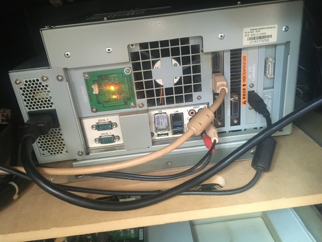

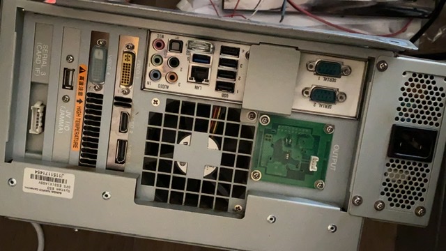

Tekken 7-fr-round 2 is all ES3 (X) system no 2 player as it all 1 player only you have to link systems for dual play

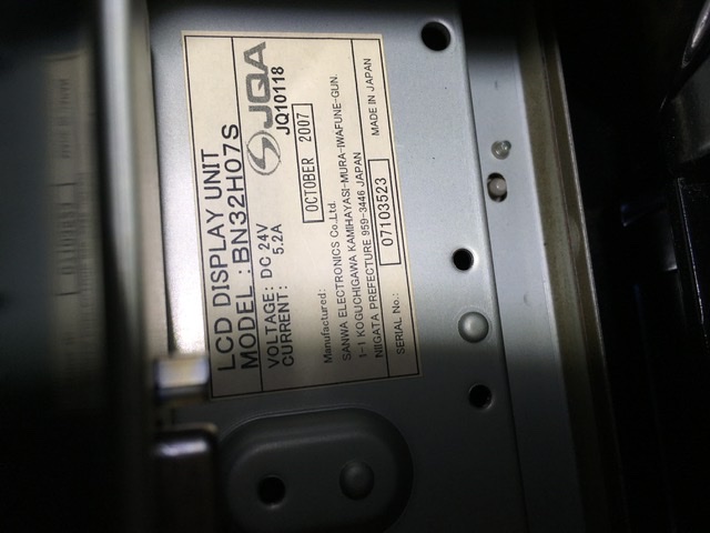

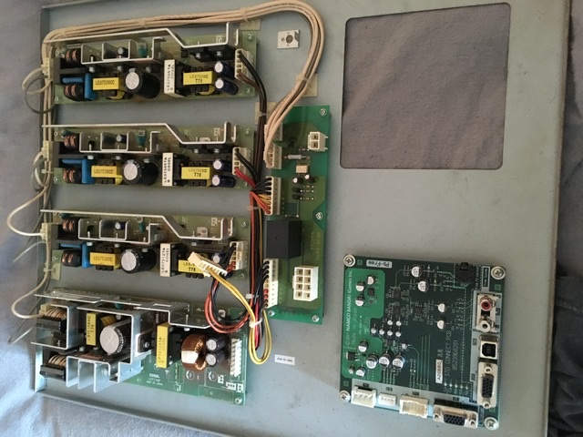

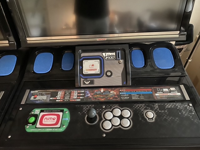

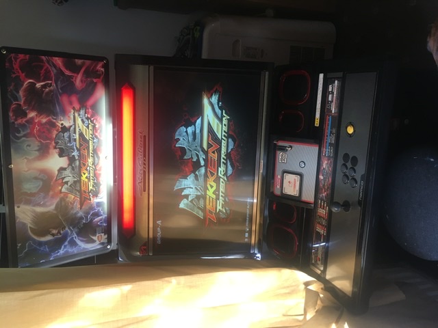

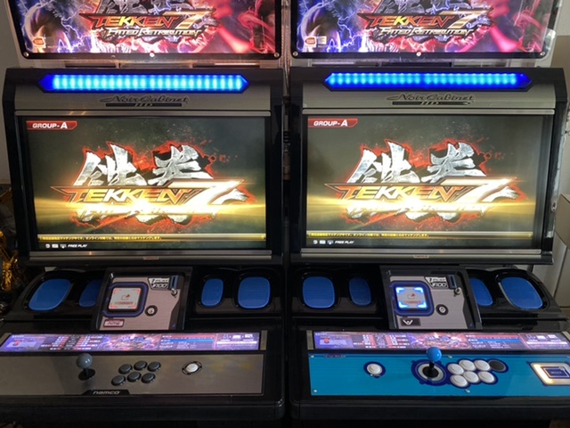

Here’s a few pics, tekken runs on es3 and takes ages to start up and not an easy game lol, my only problem is I think it’s a version 1 not a version 2

Are the noir panel and vewlix panel the same length? I have both panels (my vewlix L) and the vewlix is a repro and its smaller then the noir.
No the panel you see connected is a special nesica panel can also be used on Lindbergh. Vewlix is smaller and thus does not fit
Lindbergh and noir have the same size panel and share the same size marquee art and moves
