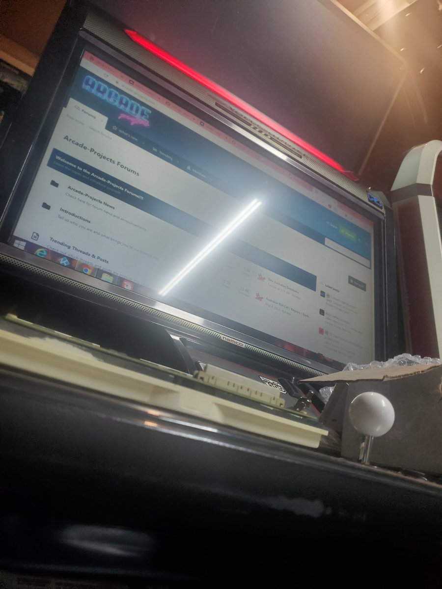

Ok hooked up a laptop to my Noir, it does 16:9

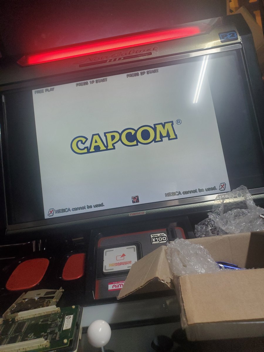

I unplugged same vga off the laptop on to my ttx3 and turned it on, it booted in 4:3.

You keep posting photos of your monitor handling 4:3 the correct way. Stretching is wrong and it seems the designers of the Noir monitor share that opinion. If you want the image to stretch, you may very well need a different monitor in there if the monitor doesn't have a setting to change aspect ratio. But like others have pointed out, you need to make sure your TTX is set to the correct resolution if you want 16:9. Your photos indicate it is not.

The noir display is defaulting to the resolution/aspect ratio of the source , your TTX3 is outputting in 4:3 once you boot SF4 and the Naomi is 4:3, the vewlix is stretching/fill the image to full screen your noir display could of done that if the control panel and OSD worked

Not really, its been suggested several times your vewlix settings must be set to stretch/fill screen whereas the noir is showing the native input with no stretching

I plugged in the laptop and got 16:9, if this was true about the osd I would have totally expected the Noir to force it into 4:3 as well.
I suspect your laptop detected the Noir display as a native 720P panel hence it outputting a 16:9 image, if you go into your window settings and configure the second display (noir panel) for 480p see what happens.
