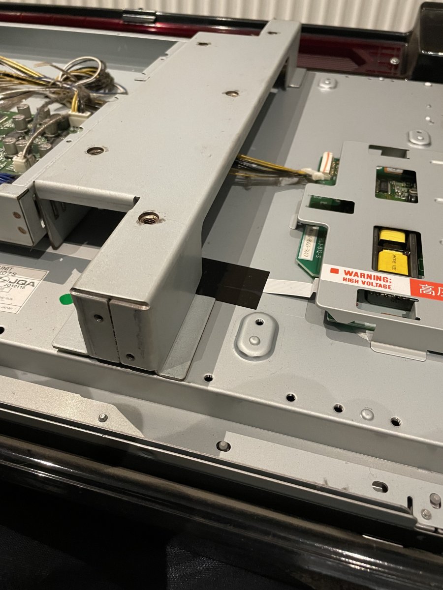

Attached some pictures. The framing is what mounts to the back to the housing which screws to the noir itself. The framing is mounted directly to the stock monitor chassis so this is lost when switching to the monitor and thus there is no framing left to screw back to the noir.

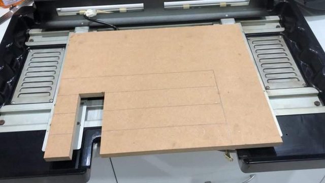

What he did was used the existing bracket, created an MDF back plate to connect to the existing bracket and then used a vesa mount to attached to the MDF back plate and mount the monitor.
If I get asked by @OsirusANZ to take these down I will - I'm sure he won't mind though :)
MDF backplate to go on the existing frame, cut out was made to access the input ports

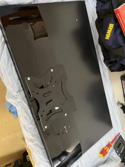

VESA mount on the monitor

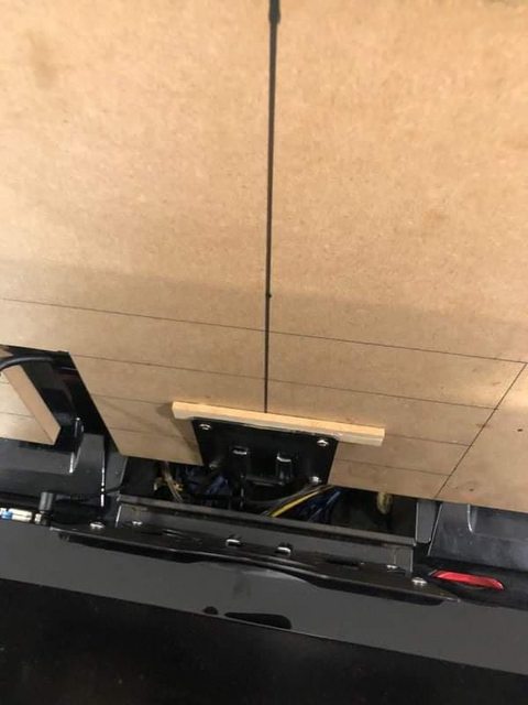

VESA mount bracket mount on the MDF back plate - I believe he used that little piece of wood to push the monitor closer to front

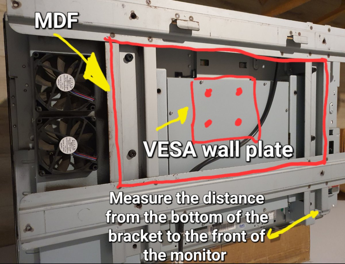

This is how I'm planning on doing it.
- Make an MDF back plate
- Put holes exactly in the same holes as the 4 bolts and use a nut to secure the mdf panel to that frame
- use an adjustable height vesa bracket (will be using this bracket - https://www.amazon.com/dp/B08NTP4P28?ref=ppx_yo2ov_dt_b_product_details&th=1)
- measure the distanced from the back plate to the front of the monitor
- mount the monitor accordingly to match the measurement adjusting with washers/nuts to act as spacers from the mdf sheet to the vesa wall plate
