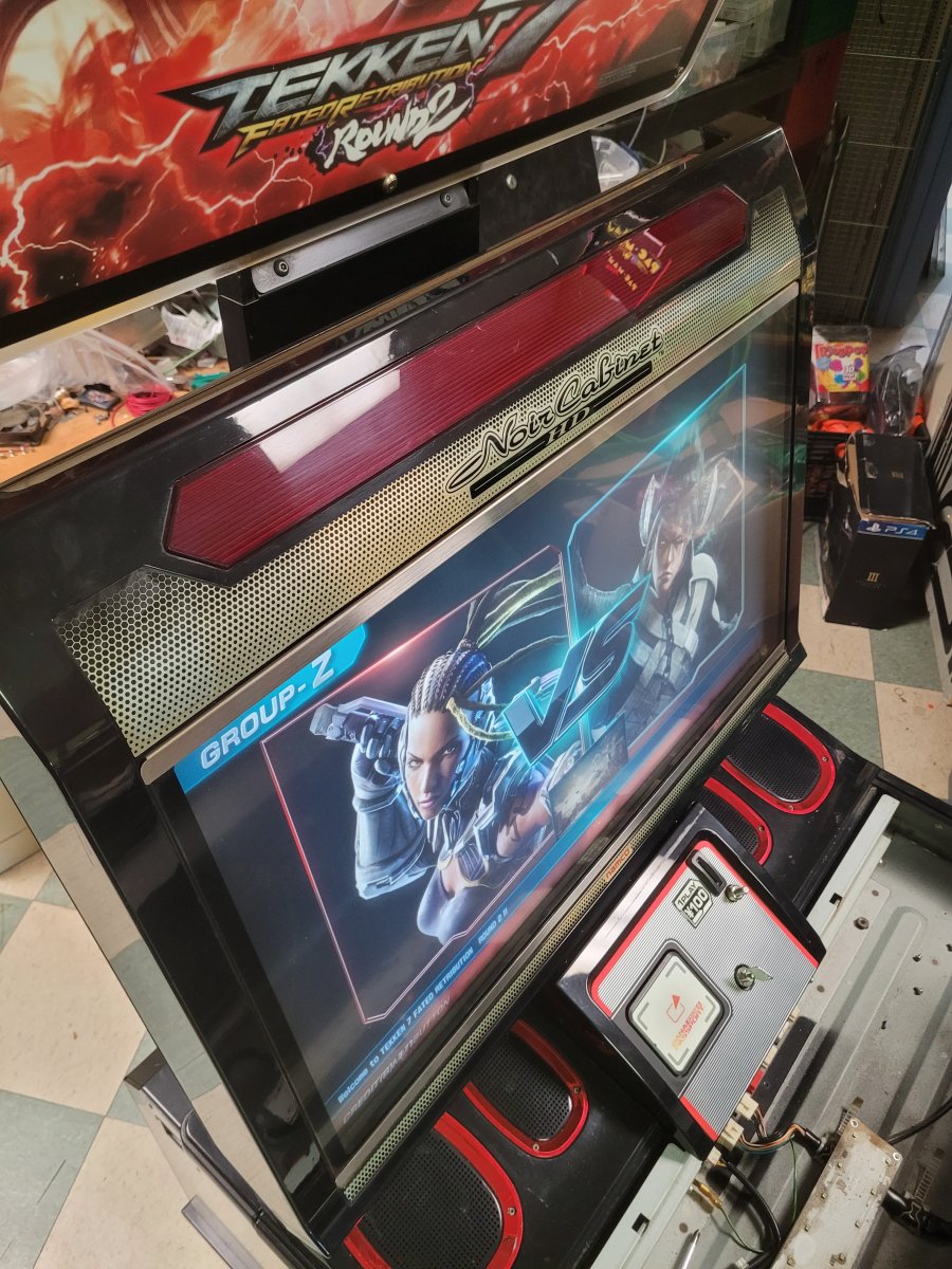

The header light was replaced but never used reason why I'm asking about the wiring. They took out the fluorescent light fixture and put in the new LED lights and never hooked it up just left the old wiring.
That's definitely the older monitor surround. The 'HD' text is below the 'Noir Cabinet', as opposed to being to the right of it.

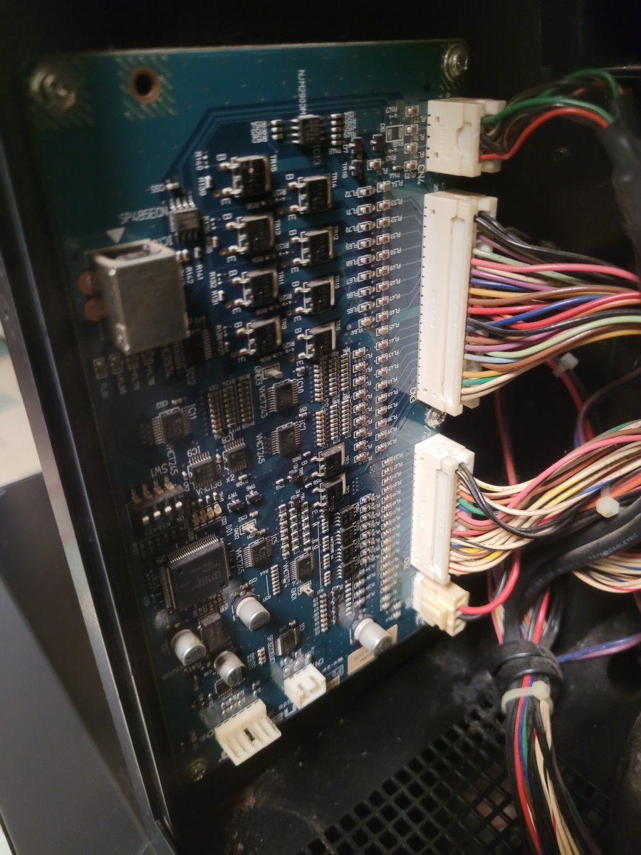

Can you show me? Also there's three wires 12V ground and? It must hook up to a board as it blinks and such on certain games ( I don't assume it's random ) so it must hook up to a PCB I can make a cord for it I just need to know where it goes
Oh yeah, that's true. I guess it's wired to the JVS IO then. Let me look into it and I'll get back to you.

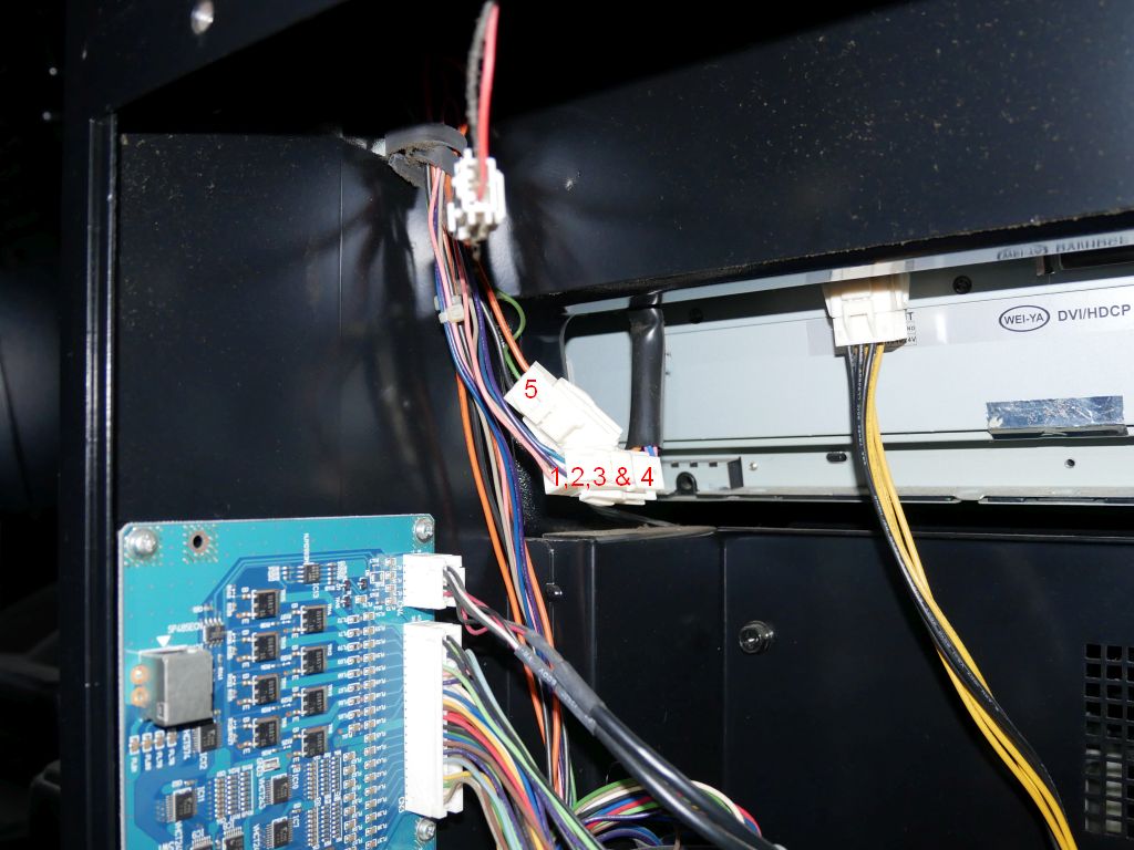

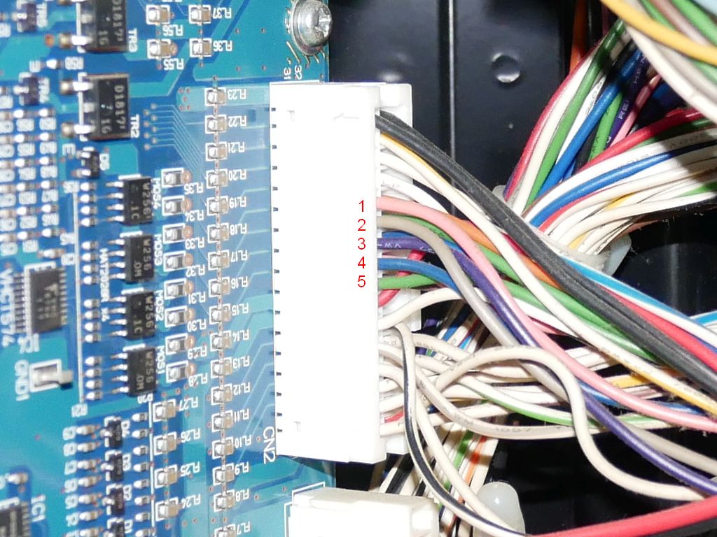

Ugh, what a convoluted mess this is.
So OK, if you take off the back cover, here's what you're looking at.
Here's an old-style Noir. I think yours is like this:
Just an AC connection going to the top of the monitor area.
On a new-style Noir, you have two connectors:
The 3-pin connector has +12V and GND. There's also a connection to the IO as the middle pin (green wire), let's call it output 5.
The other 4-pin connector has the rest of the connections to the IO, outputs 1 to 4 (pink, gray, purple and blue).

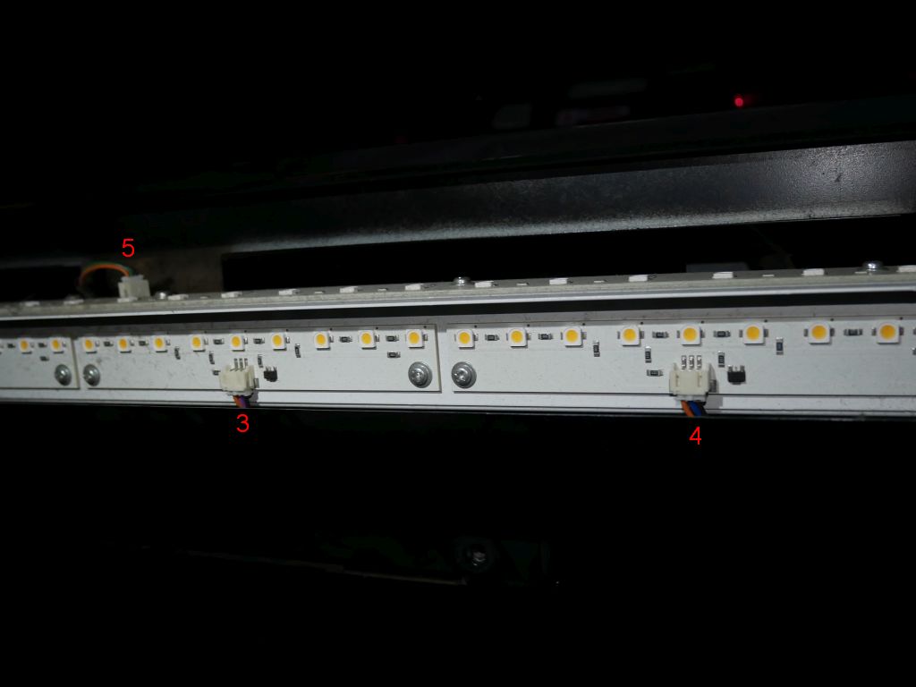

On the light fixture 1 to 4 are all on the center pin of each of the four LED boards on the top. Output five is connected to the front facing LED boards, again middle pin.
So in the below pic you have the two top boards on the right, 3 (purple) and 4 (blue) respectively, and one of the two front facing boards, that's 5 (green).

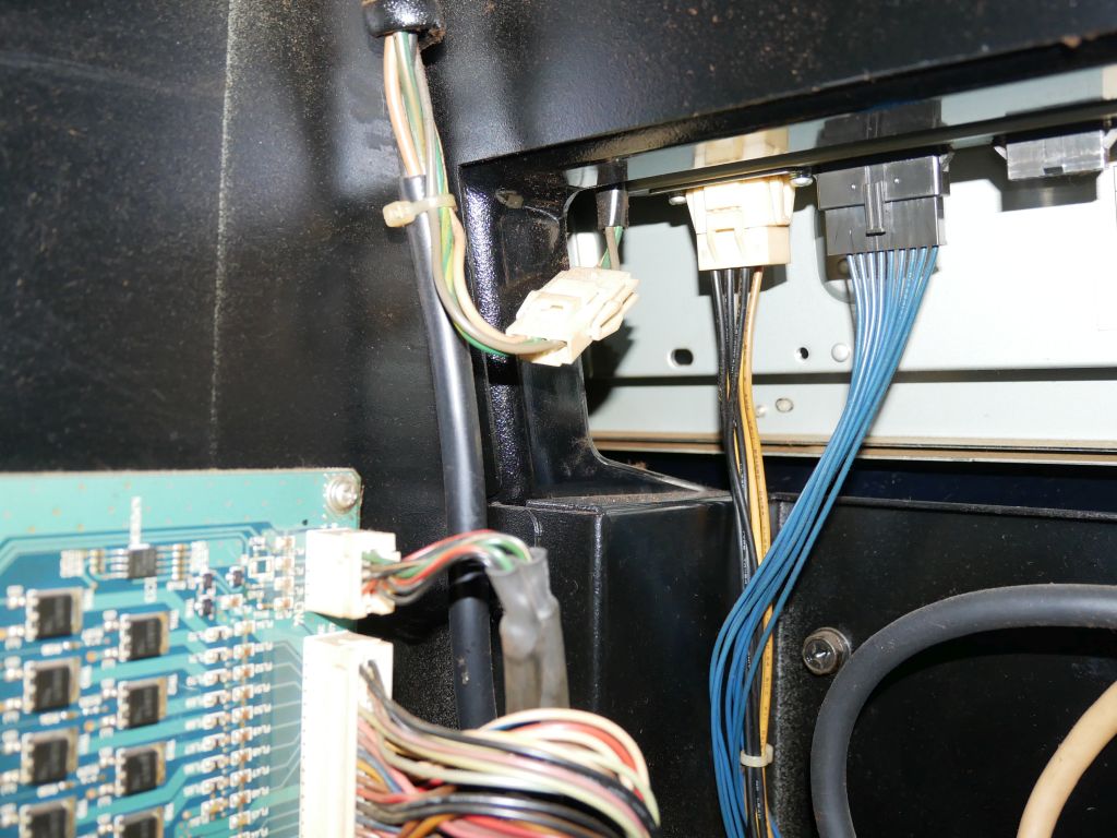

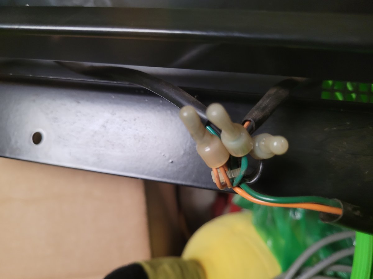

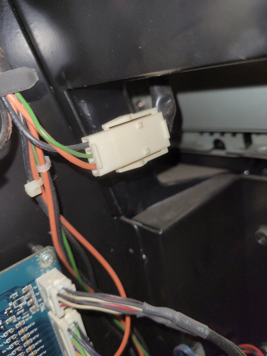

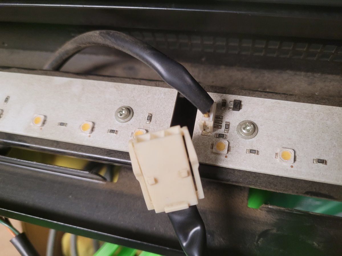

I do have that old style but...if I'm not mistaken while I do have the two LED boards I think they only go to that three wire connector.
I'll look tomorrow and take some photos of it
I have a diffrent led board all together, its all connected to that one connector :/
No, that looks like the same as mine. You just have the two front facing boards, not the four top ones.
Connect orange to +12V, black to GND and green to the pin I labeled "output 5" on the IO, and you have your lights working (provided you didn't burn them up when you connected them to AC, of course).
Do you know where a 12 volt is? I'd just splice into it same with ground
The PSU is at the bottom of the cab. The +12V wires are orange.
