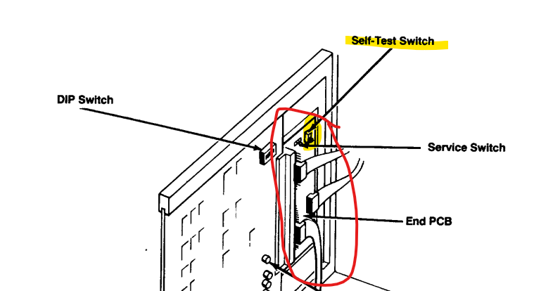

I went to "TEST MODE" (by turning on service mode dip), and scrolled thru the settings, noticed that some letters looked different, and when I landed at the screen adjustment grid, it was looking not so good (some artifacts):

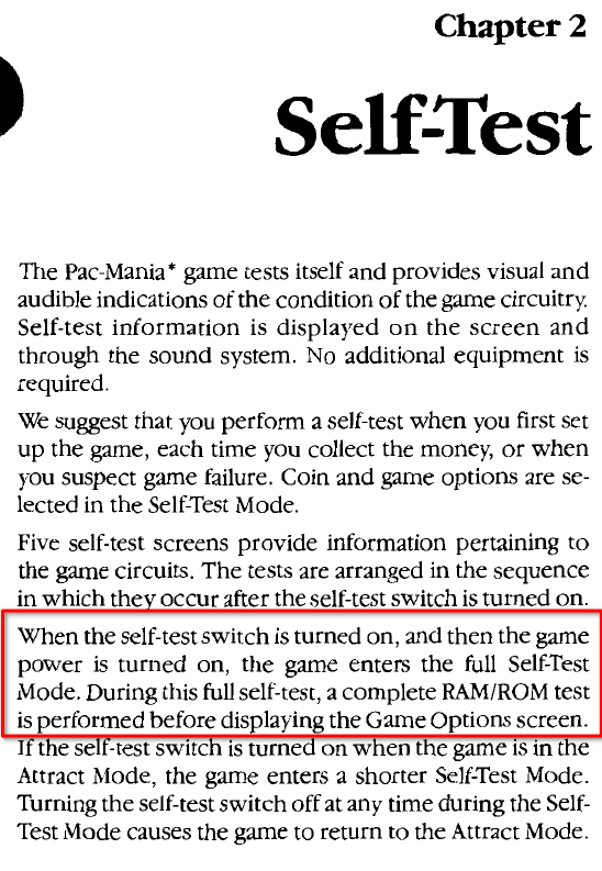

The game works, but glitchy, and if I run the self test (power on w/service dip on) I get the same RAM5 error again. So definitely the board has an issue, also I started hoping I had a RAM error and not a "custom chip that interfaces with the RAM error".

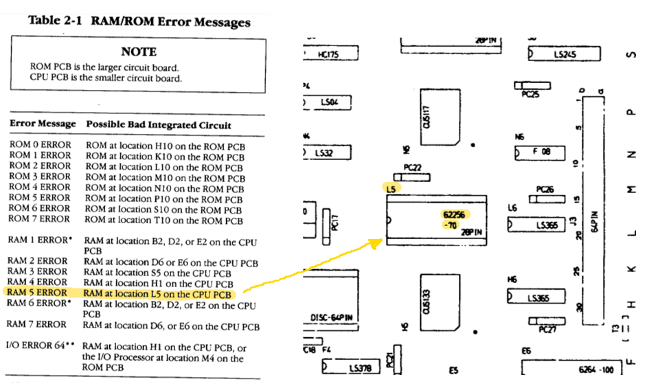

Went to the Pacmania service manual (only english namco system 1 manual I could find?), and found a nice table:
Our suspect is the L5 chip! 62256 -70 type SRAM
So I went to the board and found it, weirldy it was a -85 instead of a -70 but that's not an issue now.

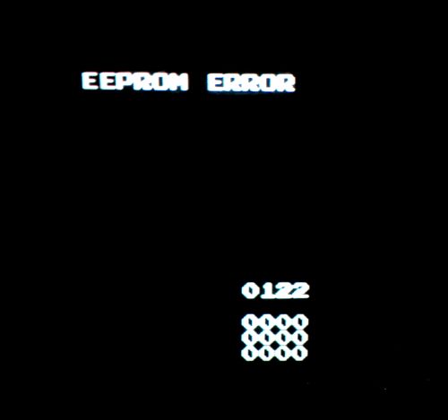

Now, when I replaced the Pacmania roms with my Shadowland roms, the RAM5 error was gone as expected, but EEPROM error persisted..
