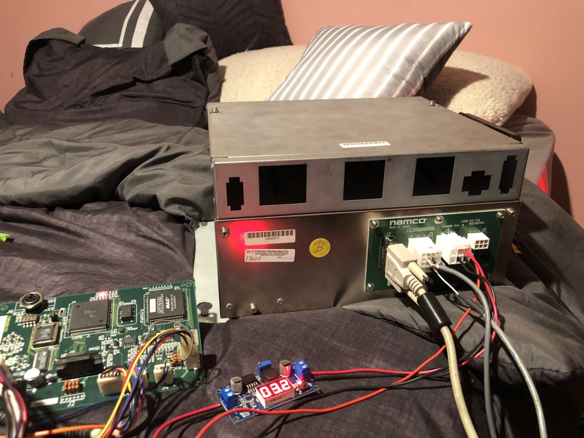

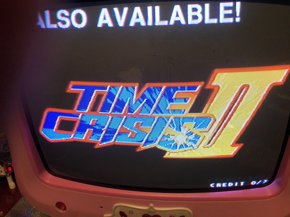

Hello everyone, I got a time crisis 2 pcb and I plan on making a power harness for it so I can use my time crisis 3 power harness and power supply with a 3.3v power regulator. The thing is that I don’t know the name of the connector used to power up the system. Looks like a sega Naomi power connector but I need the specific name or a link from digikey so I can buy the connector separately. Help would be appreciated!

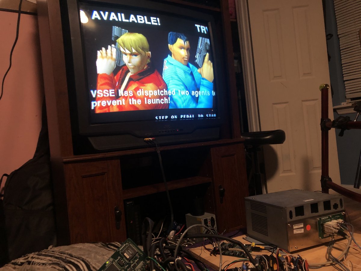

thanks to everyone!!! I’ll order some today.
Also, I can confirm the system boots up and plays fine. I’m using an original Xbox power supply to power it up. I want to use something else that is safer and like I said, I’m going to use the time crisis 3 power supply and hook up a 3.3v power regulator to one of the 5v trails.

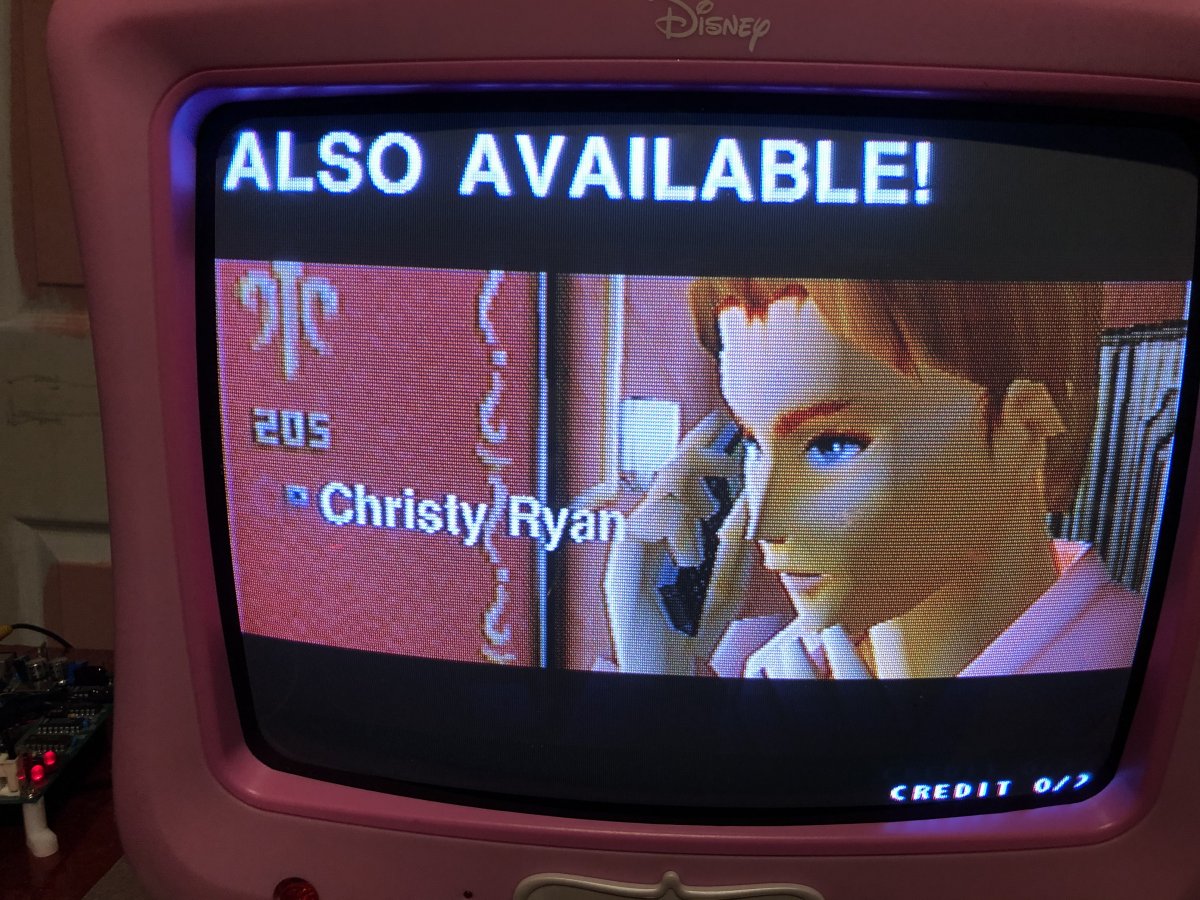

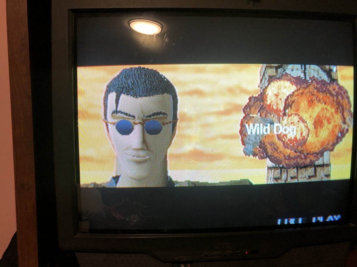

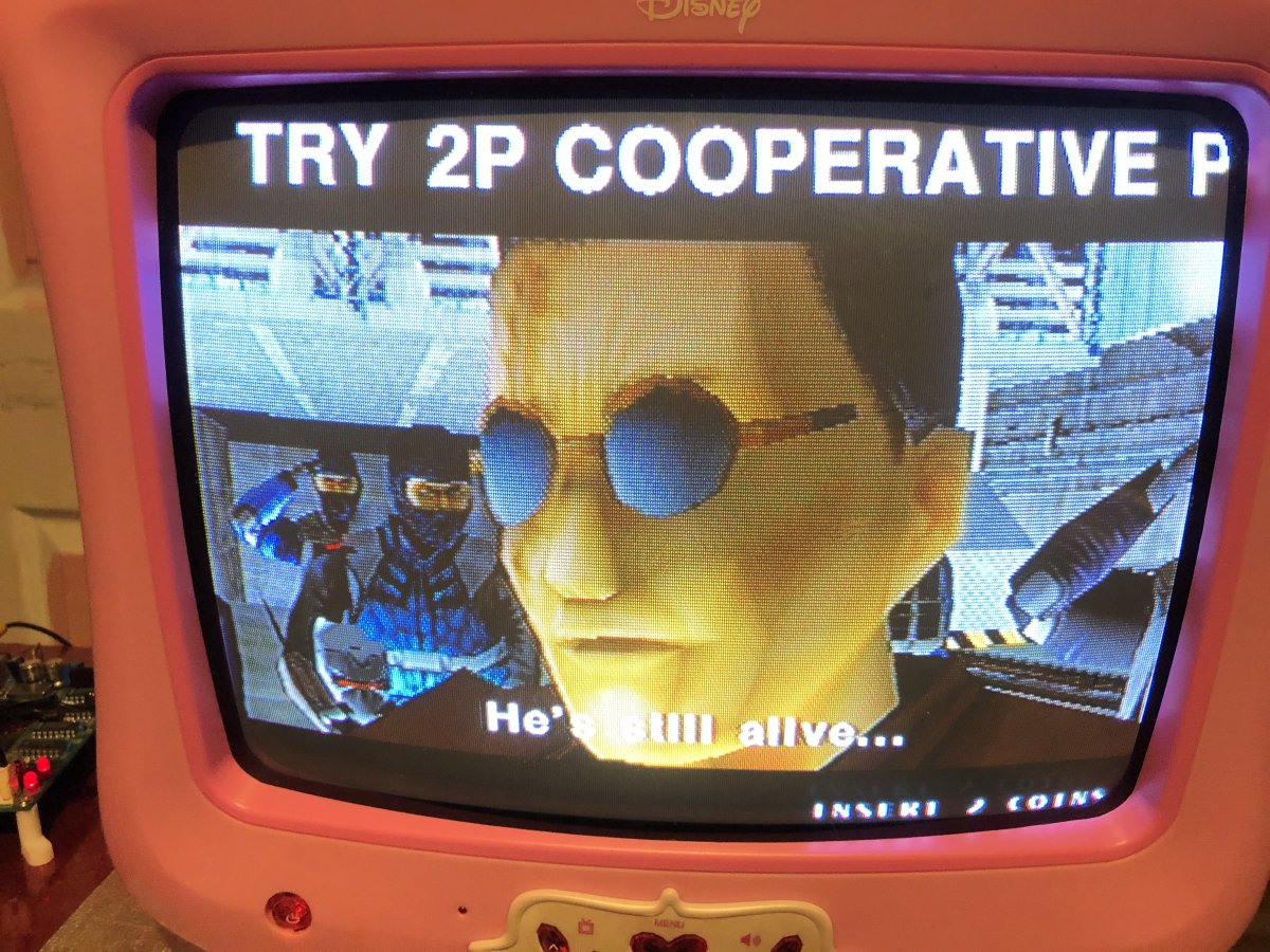

I’m using a Namco RGB to NTSC converter. It originally has an s video connector, but I have also put a rca jack for composite video. It works like a charm on any old crt tv and with any light gun or regular arcade game. From my test, it works with time crisis 1,2,3.

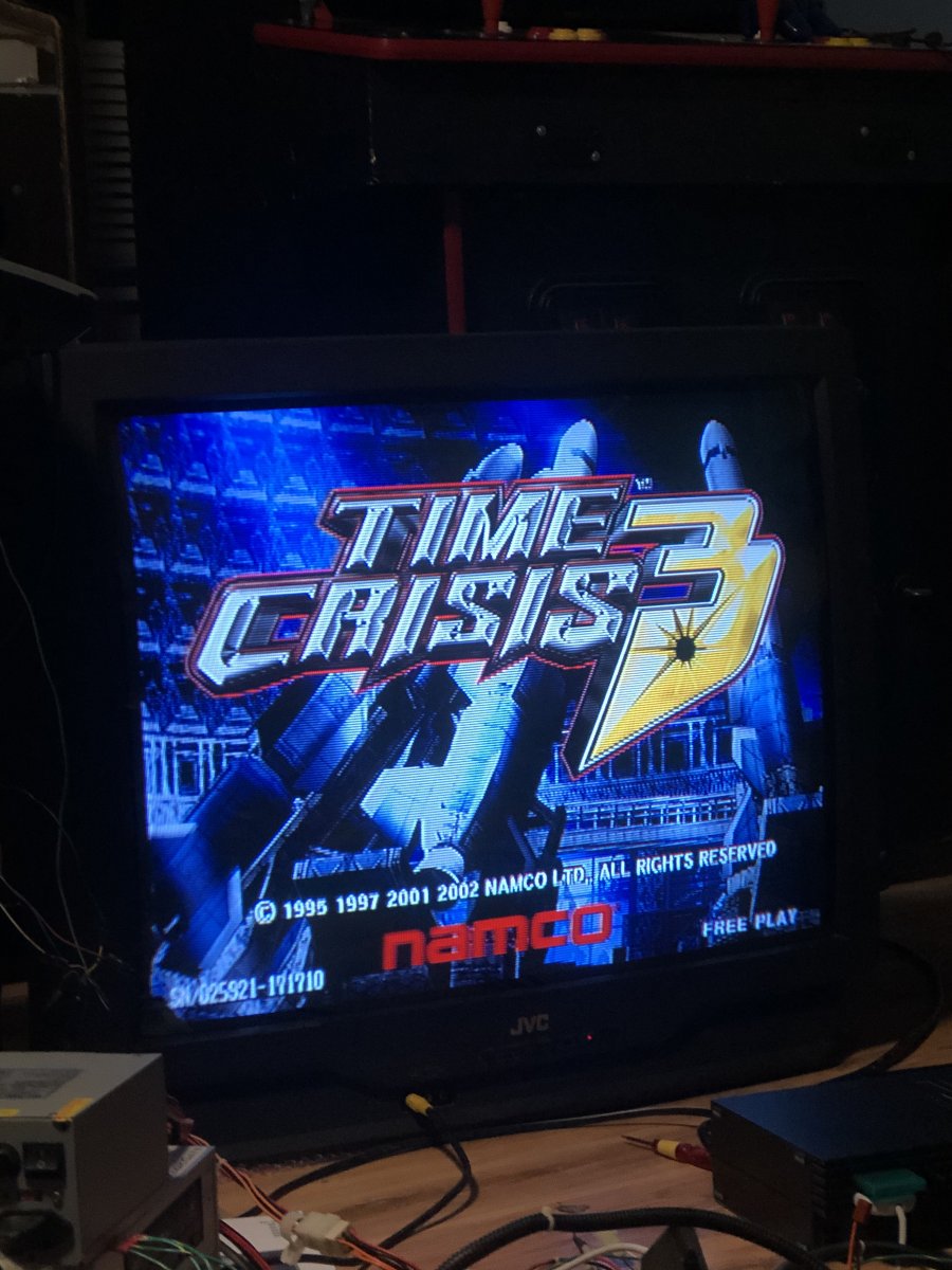

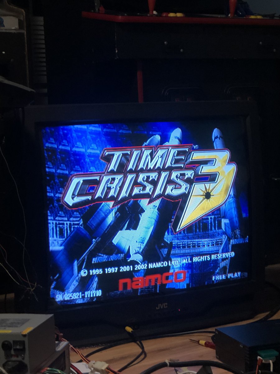

Well, finally got all the parts in to complete this multi cable of mine. I used a Namco system 246 power cable from a dead system to make a multi cable for my Time Crisis 1 and Time Crisis 2 pcb and it works like a charm! I’m so happy that I can use my Time Crisis 3 PSU now.
