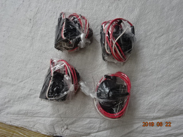

my 4 shipped I ordered. So when I get them we who am I shipping one off to get reproed.

here's some pictures
In total 100 for 4 and 60 to ship.

Whats the name of the company on the bottom of the sticker?
