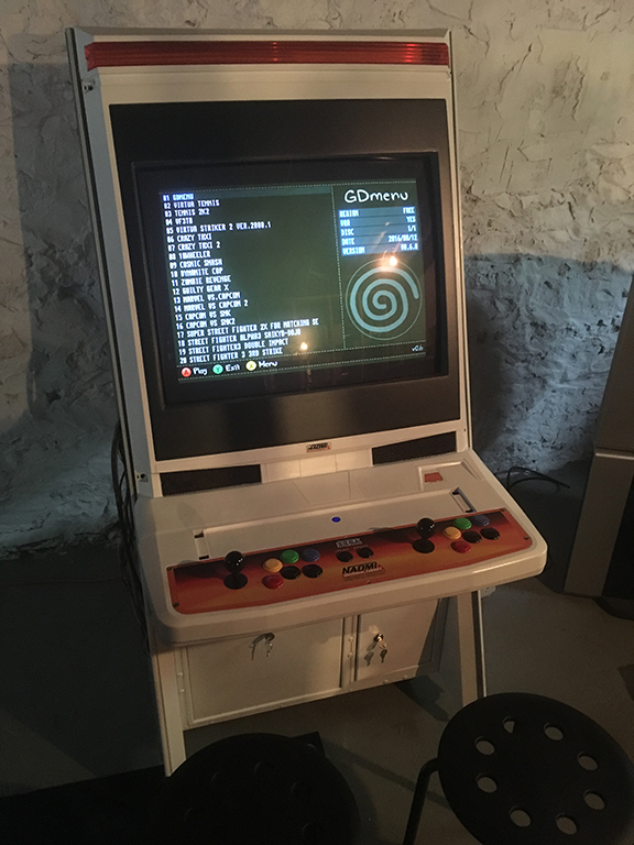

I have a Naomi Universal cab with a Nanao MS-2932. The monitor is pretty decent for the most part (despite being 31khz-only) but I feel like the displayed image is too small for the size of the monitor. Specifically, I feel that it isn't taking up enough real estate, and leaving about an 1" perimeter around the area it is actively displaying the picture un utilized. I am using VGA sources (XBOX 360, Dreamcast) and not sure if this has anything to do with while it does not appear to be filling the entire screen. I have tried adjusting the H-width and V-Width using the remote adjustment controls that plug into the monitor, and they seem to be at max width and height.
Is this normal? I don't have much of a frame of reference. I've attached an image for reference. Please take note of where the displayed image stops, and where the physical plastic bezel on the NAOMI cab begins.

I ran Dreamcast over VGA on my Net City for a while and did not have any black border, I could also adjust the V/H size to extend past the screen or create a border.

So as it turns out, I was able to remove the cover off the back, and adjust some of the pots (H-size, V-size, H-pos, V-pos) on the chassis in addition to on the tethered remote board, and to greater effect. It strikes me as odd that they would have repeated controls on both, but it worked, so I am not complaining. Just thought I'd post my conclusion/solution in the event that someone else runs in to this issue.
