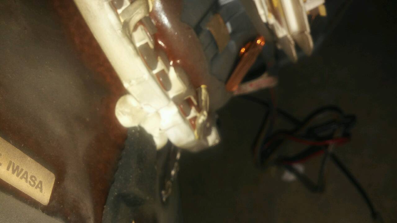

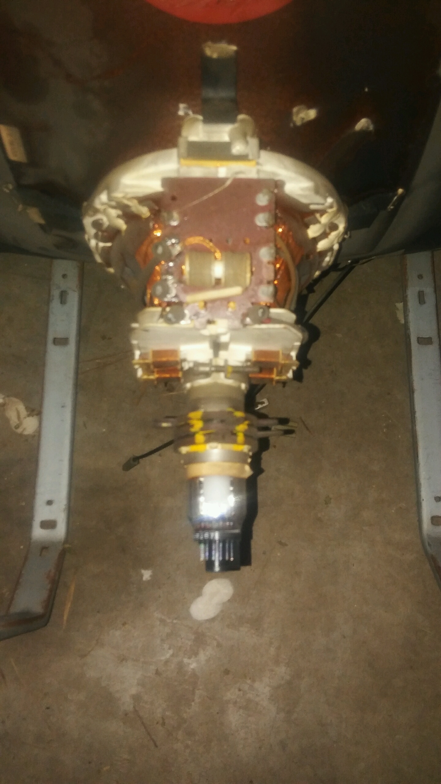

Seriously though... I decided today to pull the yoke from my 2931 tube. It's exactly as I thought, broken at the base of the CRT. Sadly. I'm going to part the monitor out tomorrow - pull the degaussing coil, frame, and whatever wiring is there, then junk the tube.

From what I've read on ArcadeOtaku with various users, the 2934/2932/2931 are all compatible with the 2934 tube with just a chassis swap. Anyone have any particular experience?

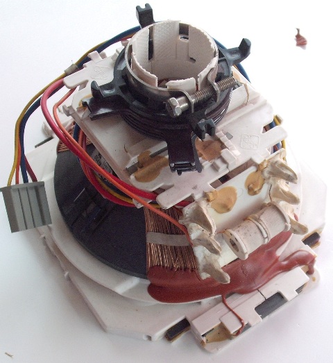

I gather from what's already been said here and from what I've read on arcadeotaku, take yoke readings to be safe - if the yoke on the 2934 is no more than 1ohm higher, then it's good for a chassis swap. If lower, need to swap yokes too. Is this correct?
when I repair any of the 2930-2934 chassis I use the yoke from a 2931 and it works perfectly, there will be some minor differences in the yoke readings but they are well within tolerance.
Awesome... No problems later on with chassis fizzing out or anything down the line?
It's sounding like I need to proceed with the 2931 chassis repair, then prep to swap yoke and chassis. Once I get the 2934 tube, I mean.
