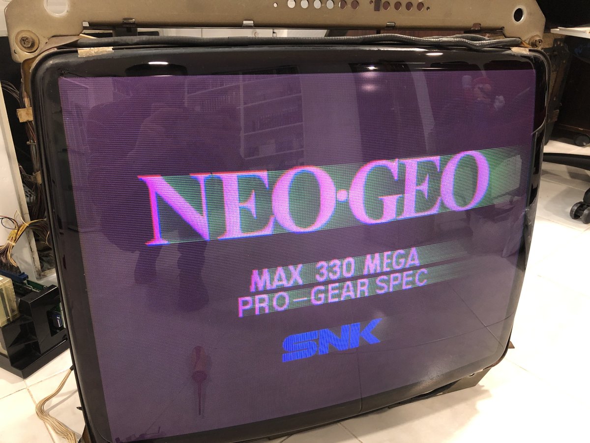

Edit: one more unrelated thing. Since the first day I got this monitor, when turning it on, it initially only shows red color and slowly adds more green and blue as time goes by (it takes 3-5 minutes to show a balanced image). Presumably this would require a recap to fix?

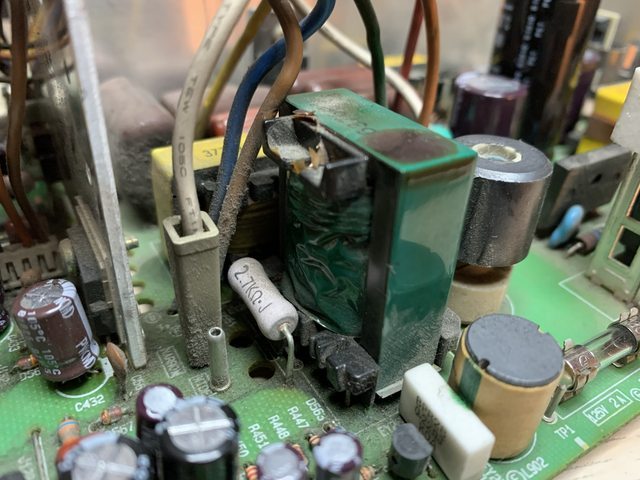

My MS8 had a high pitch squeel. It ended up being one of the coils which I replaced. Gently press down on each coil with a wooden utensil to see if that stops it.
These coils? (I’m completely clueless, and scary, with CRTs…)
Not quite. They come in all sizes and colors, but the one that was buzzing on mine is this green one.
Although if these things really scare you, maybe a professional might be better. I mean, they're terrifying, but only work on these if you're really comfortable with it. I'd hate to see you get hurt.
Yeah, I might just request a professional to take a look at it. Thanks for helping anyway!!

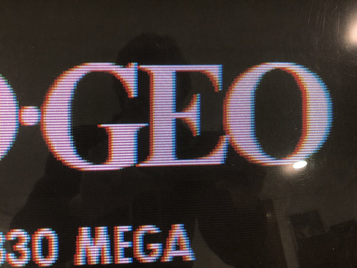

Today I put the back cover into its place after deciding to not try anything else and… a few minutes after power on the noise reduced its intensity but the image started shacking slightly and the red channel is now offseted a few pixels to the left 😭
I think I’ll just ask for professional tech help but if anyone can think of any quick (and unrisky) thing to try, I’m all ears.

- I managed to improve red vertical convergence by adjusting the rings. The weird thing though, is that the rings came yellow-marked and they hadn’t moved. How can red vertical convergence be affected if the ring didn’t move? Could this be related to the buzz at all?
- As mentioned above, this tube always takes its 3-4 minutes to get all colors working (video). When turning on it only shows red. If I heat the whole monitor with the hairdryer before turning on, colors are good when turning on. What can be causing this?

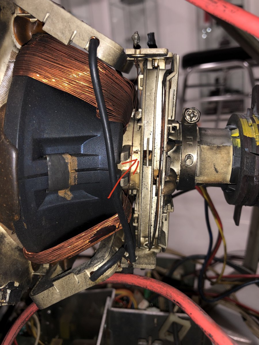

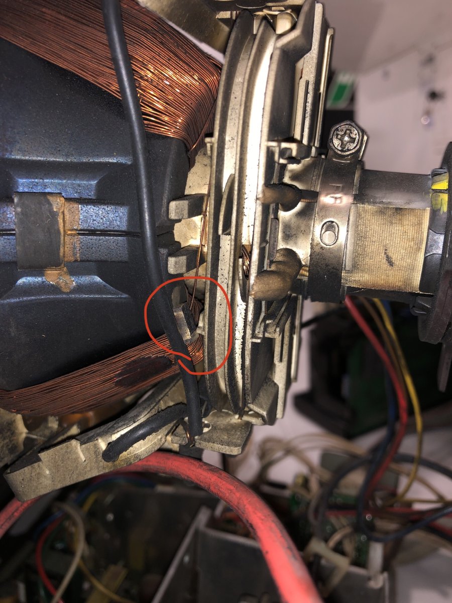

I finally fixed the buzzing sound! It was actually some magnet that fell from somewhere and would vibrate when the monitor was on:

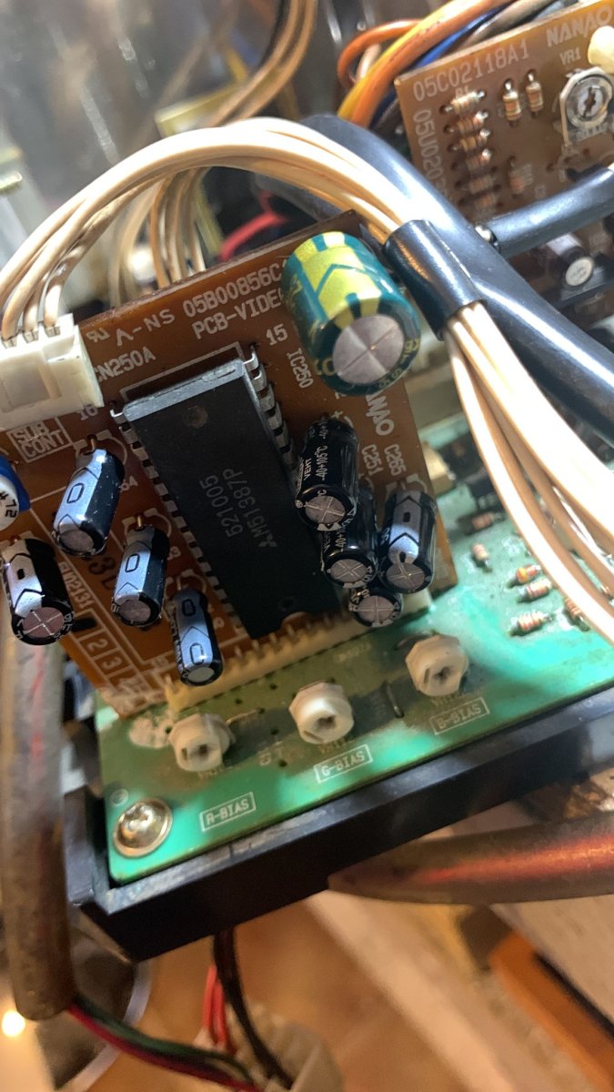

I also sent the chassis for repair. They fixed the coloring issues (image was all red until the monitor warmed up) The culprit in this case was a leaking capacitor. They fixed it by replacing many components on this little board:
Progress!!

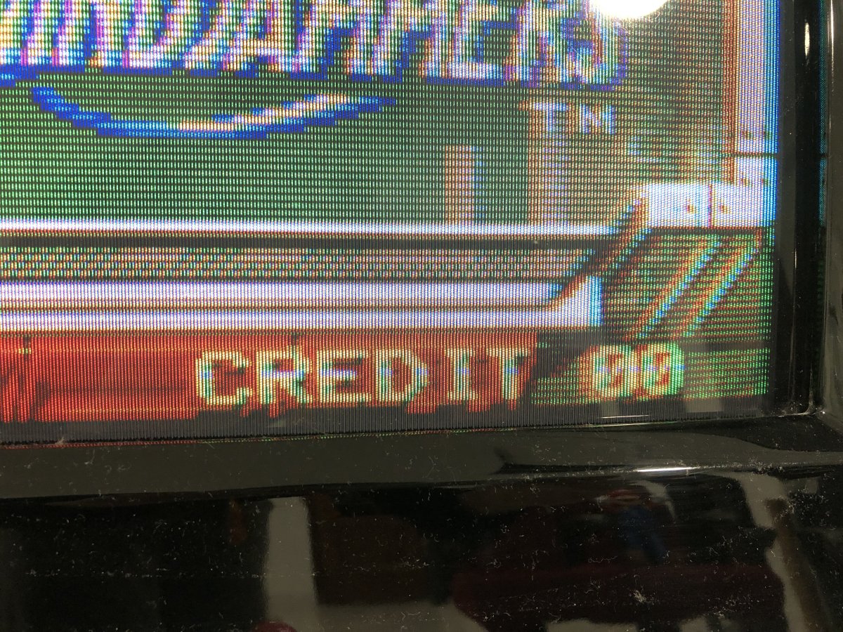

However upon connecting the board after receiving it back, now I ran into a new issue… the green is all messed up, like shifted projecting a shadow to the right. Any ideas?

The magnet is probably from around the edge of the yoke--there's usually some mounted on the front/back of the rim that's up against the tube.
Usually C332 on the neckboard is the culprit for that type of issue (160v 10uf for MS8-26SG).

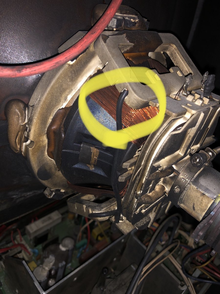

I found the place it fell from by comparing to the opposite side of the yoke:
How does one stick it back into its position, does it stay in place by pressure of the surrounding plastic, or does it need some kind of glue? I’m thinking of using some small pliers to put it back.
The green color issue fixed itself this morning when I tried turning the G Gain in the remote board. Not sure if it was coincidence, I’ll try it again later, otherwise I’ll check those caps.

They're usually held in place with that white/yellow silicone adhesive. They'll slot into place, but the glue helps keep them from falling out.
I managed to stick back the magnet back into its position. I used a thin double side tape and it seems to firmly stick. Convergence looked normal again and games looked fantastic! I couldn’t be happier.
