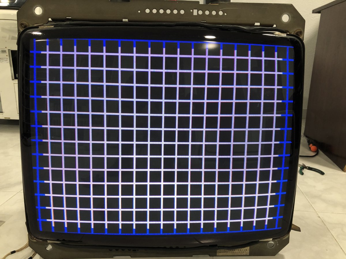

Wow!! I didn’t know it was a rare variant of the MS8! It certainly looks amazing when it works well, probably better than anything else I’ve seen despite the tube having a decent amount of burn in.This is the best dual freq chassis ever made by Nanao, it Is a rare variant of ms8 29 which come with the same rgb amp ic of the ms9, it has the same easy color and withe balance of the ms9 but it is alltheway sharper like any ms8, the noise is just hv leakage most likely from the anode cap, verify that and if it is the case go to replace the anode cap and metal clip. If it comes from the flyback (I do not beleave) you can cure by apply "super corona dope" Coating.
The noise was finally fixed. It was a magnet that fell off from the yoke (check this video). I managed to put it back and the noise and convergence issues went away.
