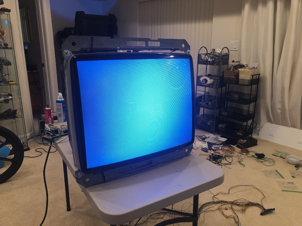

OK so big update *doh* had someone say "have you checked the brightness is turned up on the flyback?"
so here we are :) however it seems I have some dark edges... not sure whats up here
