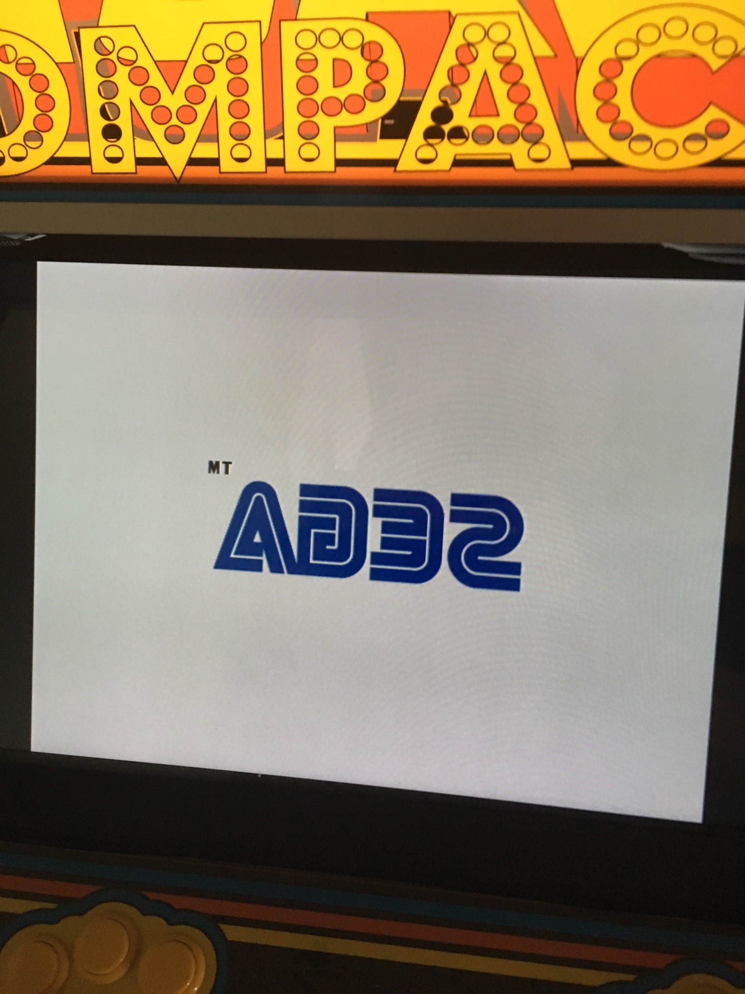

one funny thing i forgot the other post - sometimes the virtua cart does not stop with a black screen - sometimes it stops with a mirrored sega logo ?( IMG_0738.JPG
This EXACTLY happened to my virtua tennis cart - never figured it out... the naomi was perfectly fine though - so the cart must have died on me.

nobody so far said something about that particular symptom... - what i saw when i opened it up again is that there's jumper next to eprom - i wonder what that does?
