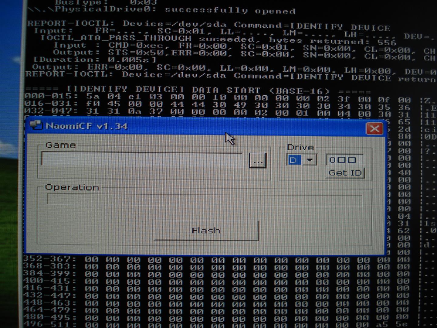

I've just come across a strange problem. I bought a box of 20 industrial grade Delkin 512Mb CF cards supposedly made in the USA.
When I use "smartctl -a /dev/sda" I get "00 00" as the card ID for all 20 of them, they work OK with the G-net & my old camera - All my other cards read fine (apart from a 512Mb Cisco one that windows doesn't pickup either).
If you use the flash utility it won't let you put "0000" as the code. Any ideas???
Or am i stuck with using them with my G-Net PCB?
Are you using an IDE reader? I've only used the NaomiCF proram to pull the ID and it requires an IDE reader.
I'm using a laptop with PCMCIA CF adapter (like the tutorials state) as my SATA to CF adapter wasn't picked up correctly and my PC only has SATA ports.
I've just retried using an IDE-CF adapter on an old XP PC I had in the garage - and get the same results.
I can read the ID's from all my other cards and the one I got from you with it no problem. Just this batch of Delkin ones - they all show 00 00 at offset 36/37.

Not sure if it'll help, but i'd definitely double check using a true IDE adapter than PCMCIA. it's possible the chipset is treating it as flash memory and not an IDE device.
He said he tried with an IDE with an old XP computer (same type I use btw)
Sounds like your cards might just not be compatible for some reason. There are a few brands of cards I've had zero success with when trying with Naomi.
Just for shits try programming with the code ID 3030.
There's definitely something odd about them - NaomiCf.exe shows 0 and two squares for the ID. the other card ID's it agrees with, my Linux box gives the same string of "00 00" for offset 36/37.
I'll try programming them as 3030 as the program won't let you enter "0000".
