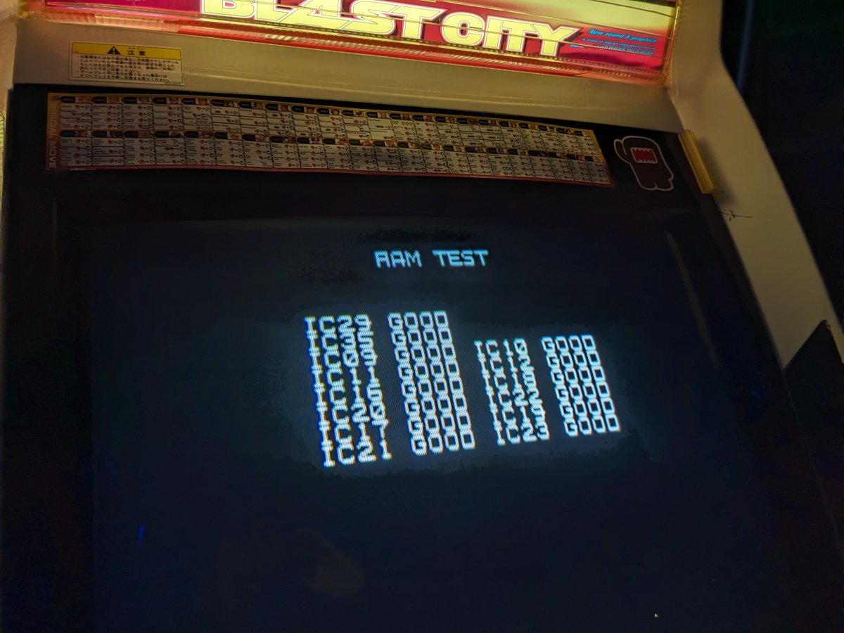

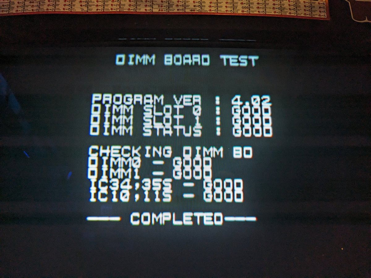

I got a JVS power extension cable with a voltmeter from Lemony Vengeance. Only the display for 3.3v works but I used a multi-meter to check the 5v pin while CvS2 was running. I tweaked my Sun PSU to have the correct voltages. 3.30v and 5.00v on the dot. Nothing has changed and every game still freezes constantly.

I had freezing in the past with my Naomi 2, my main board would test "GOOD" on all RAM tests, but after testing multiple times it eventually showed one of them to be "BAD" (in my case, it was IC114). Replacing it resolved the issue. I know of at least one other Naomi 2 user who had RAM test report "GOOD" after freezes, but went ahead and replaced the RAM anyways one section at a time. They replace the ELAN RAM which ended up resolving their issue.
I don't know how common getting false positives are, or if they are more/less/equally common on Naomis vs Naomi 2s. It is possible you may be experiencing something similar however. Unfortunately after ensuring proper voltage on the 3.3v and 5v, it can be a bit difficult to isolate issues with these systems (at least, in my limited experience).
I had a stick of ram in my netdimm that was bad but would always be "ok" on the test screen. I had similar random freezes until I swapped it out. You might try some new ram sticks.
So the RAM is in the netdimm? I always assumed it was in the motherboard. I'll check mine out later. I'll run the memory test a few more times too since I think I only did it once. Thanks for the info.
Good idea to swap around the NetDimm ram and/or reseat the NetDimm its self.

I have a flaky Naomi 2 mobo, but it only ever boots or doesn't boot. Once booted it's reliable for over 24 hours.
On the other hand I had bad ram in my net dimms and that had similar problems. Games crashing, errors during transfer, etc but it would still pass the ram check. I cleaned the dimm slots with deoxit and bought new ram on eBay. I think using one stick is more reliable than two too.

I opened up the netdimm and I thought one of them looked a little loose. I reseated both of them but still had the same problems in the same games. I tried with just one stick. Same shit. When I tried with the other one, I got no video on the monitor and the Pi couldn't connect. I put the RAM back the way I found it and I'm still getting no video and no connection.
