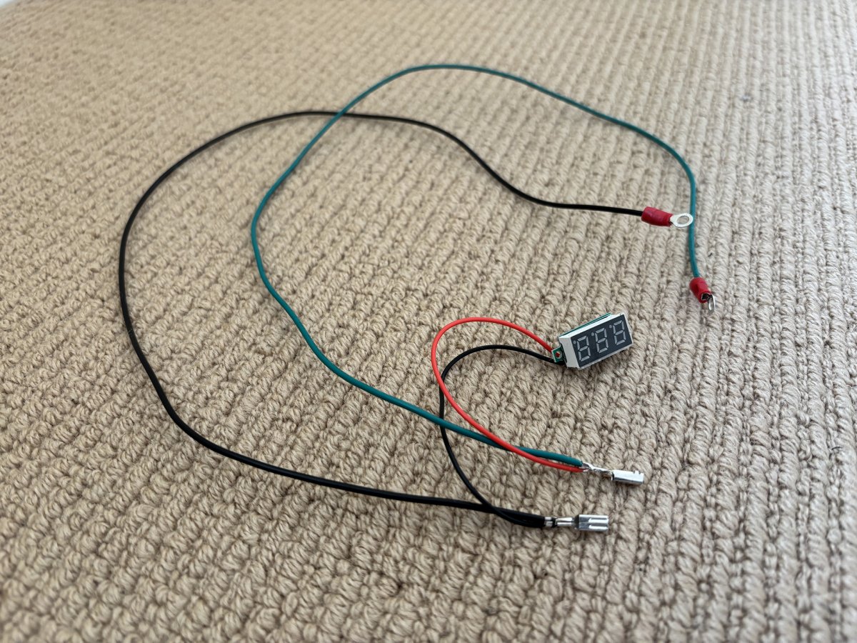

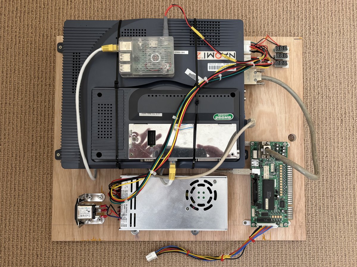

Besides to buy a brand-new PSU and make a new harness for it, I thought to incorporate three digital voltmeters to the setup.
All sorted. I had a number of long sessions of gaming with issues anymore.

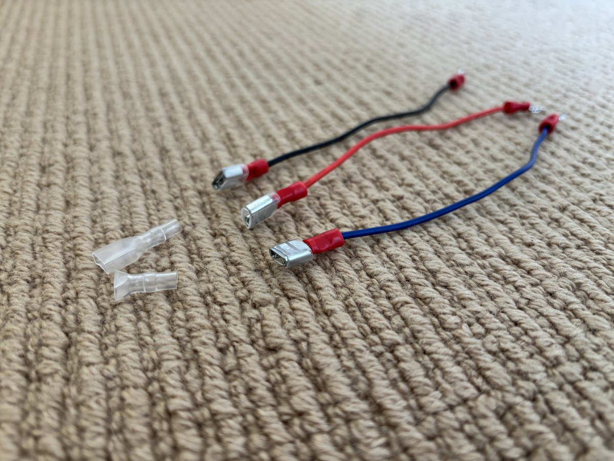

Wiring for the voltage input
A sample of the voltmeter wiring

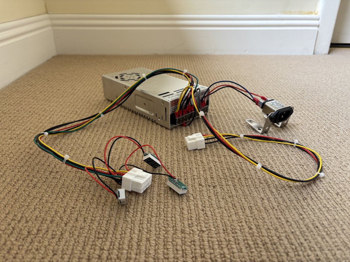

Full wiring setup on the QP-150-3A. You can see that I incorporated also a IEC 320-C14 connector which will make the Naomi setup compatible with all the different inputs voltages and plugs.

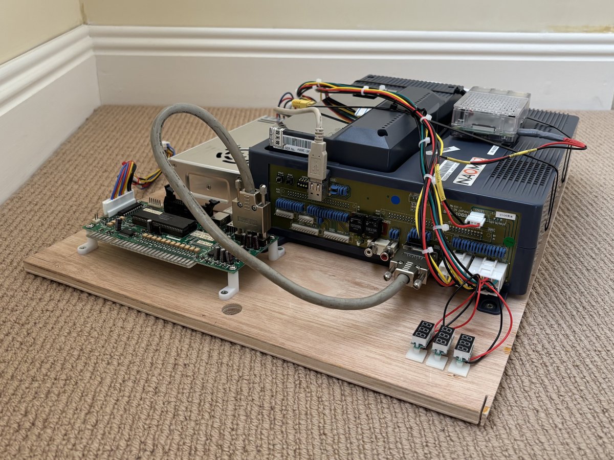

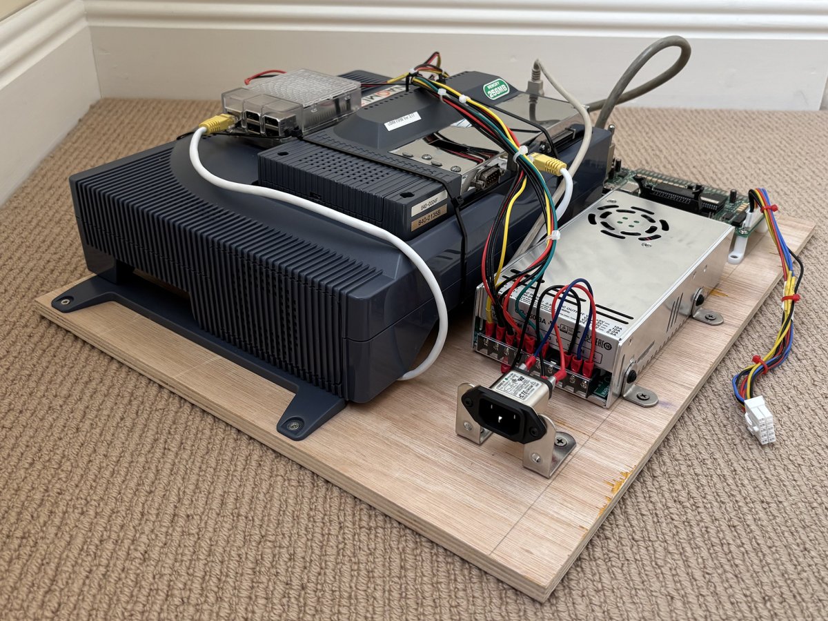

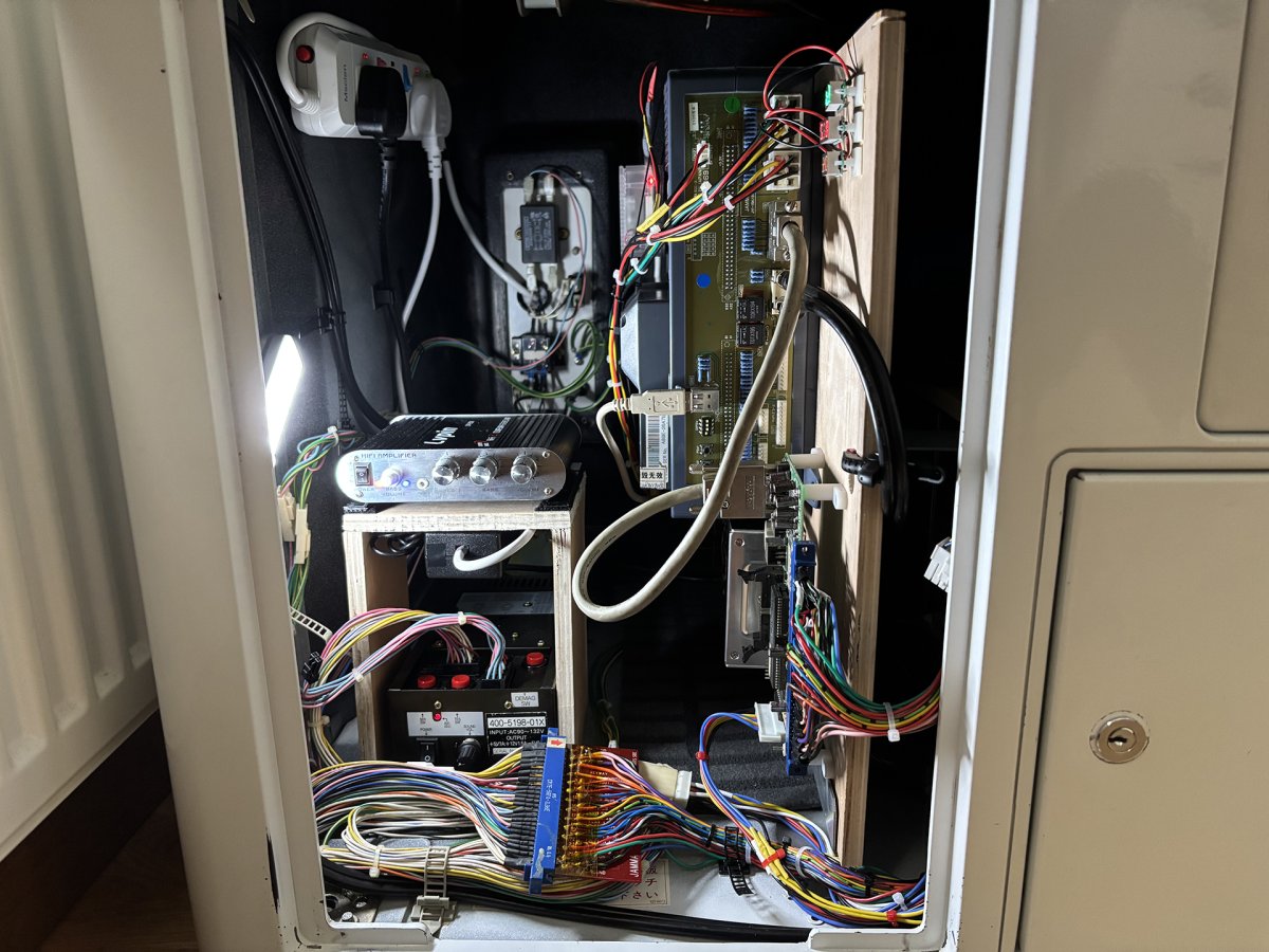

A few pictures of the setup complete. I used it with my New Astro City mostly so I installed everything on a plywood board of similar dimensions of the existing one, so I can easy swap the board. (In the final version I relocated the PSU brackets on the opposite side to avoid any conflit with the board rail)

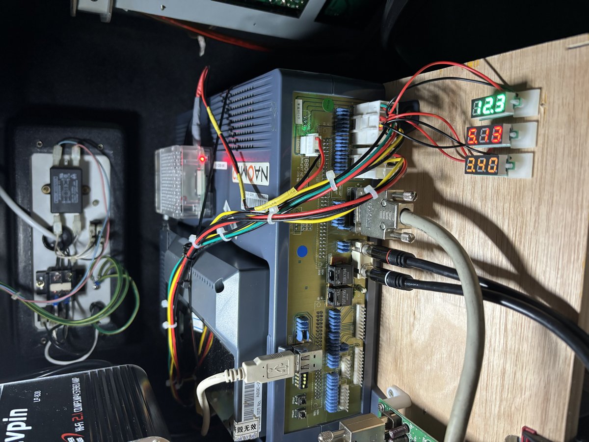

Here is the setup in the cab.

Agreed, tidy setup!
I would dial down the +5V. I wrecked a Zero Gunner 2 cart and a DIMM board with a PSU that was running at 5.15V.
Thanks!
I gave more power to the 3.3v output (which was 3.3v originally)
I didn't touch the 5v output, but I will follow your advice and lower it down a bit
