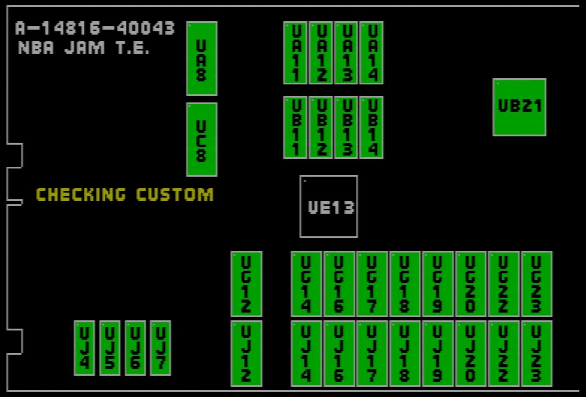

I've recently picked up a beautiful looking NBA T.E. board set.
While testing it, I noticed it was out of screen bounds (see attached image, right hand side). I scanned over the board looking for a horizontal/vertical adjustment pots but didn't see any- have I missed something here? Is there a means to adjust the image, or is this an indicator that something else in the chain is problematic? The board is running out to a HAS V5, which sends the video over to an OSSC Pro, that then pipes it out over HDMI to my ElGato HD-60X.

adjustment like that is usually done by your CRT monitor, NOT the game PCB. in this sense it's your OSSC where you need to fix this.
Aha, yeap, OK! I suspected as much when I didn't see any pots on the board; I appreciate you confirming it for me.
[EDIT:]
Confirmed OSSC Pro settings change corrected the matter.
