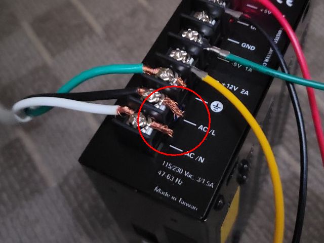

Also, this is an accident waiting to happen:
Trim those ends.
Trim those ends.
From research, some 2X6 games allow for the PS2 controller ports to function, and my original plan was to adapt a VO Twinstick via Retropad32.
Yes I'm fully aware it's dangerous, was a quick hack job for testing, that cable is probs gonna be trashed.
