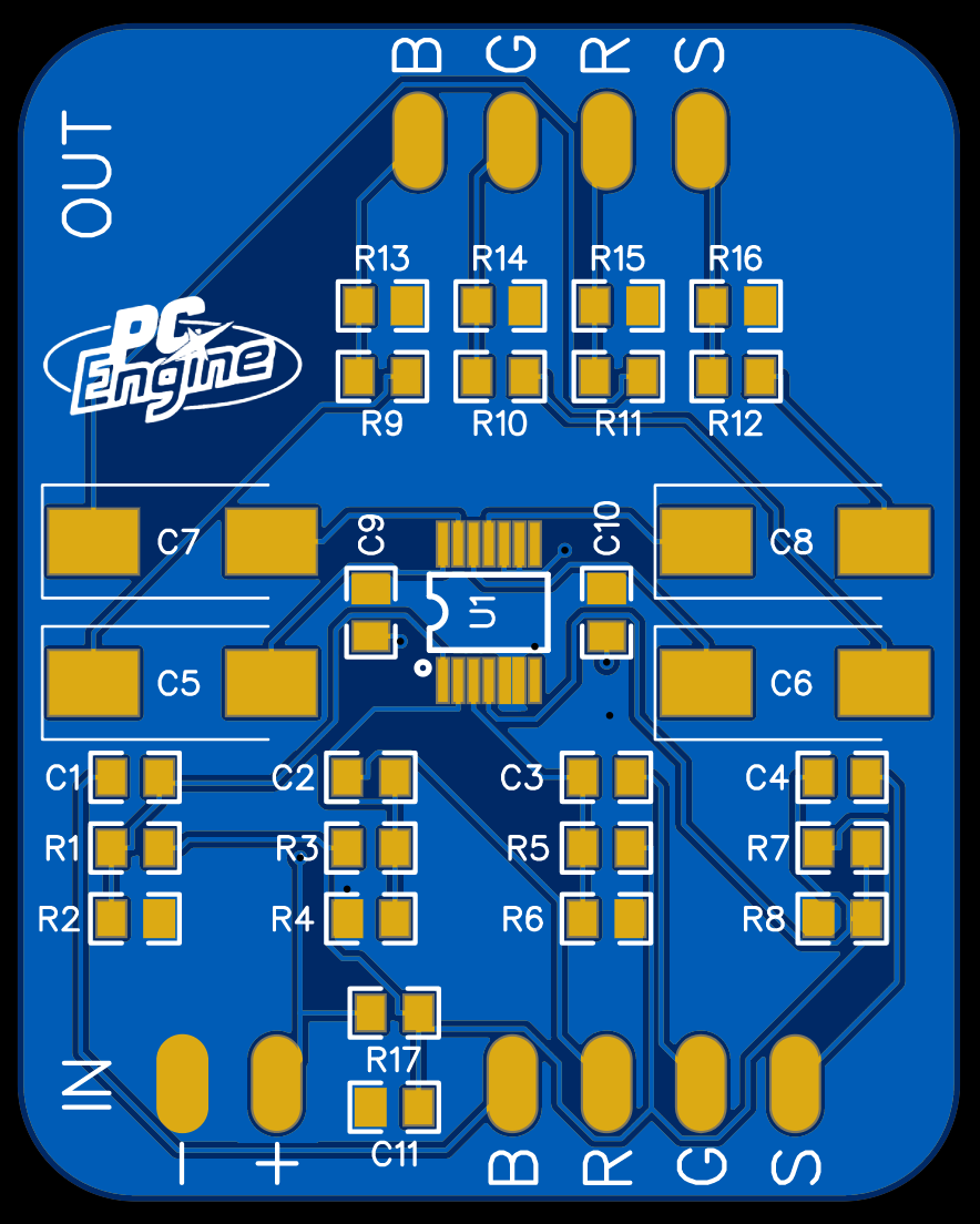

I'm still plodding away at this. In a draft phase however I believe I have a sound circuit courtesy of some communication with Tim Worthington.
THS7374 based, bypassing the internal clamp, AC coupled, power filtering to eliminate high frequency noise entering the video signal, DC offset on output.

Nice design Frank!

The cool thing about this is that folks can make use of it for other applications. Like, I've been wanting a discreet RGB amp for gutted MAME cabs but my skills aren't there yet. @Sp33dFr34k needs something for his situation. So since this is going to be opensource, will provide a blueprint for other applications.

I've been looking all over for a project just like this but it looks to have stalled. @Frank_fjs any plans to pick it up again? It would be great if there was at least one well designed open sourced PC Engine RGB amp out there.
