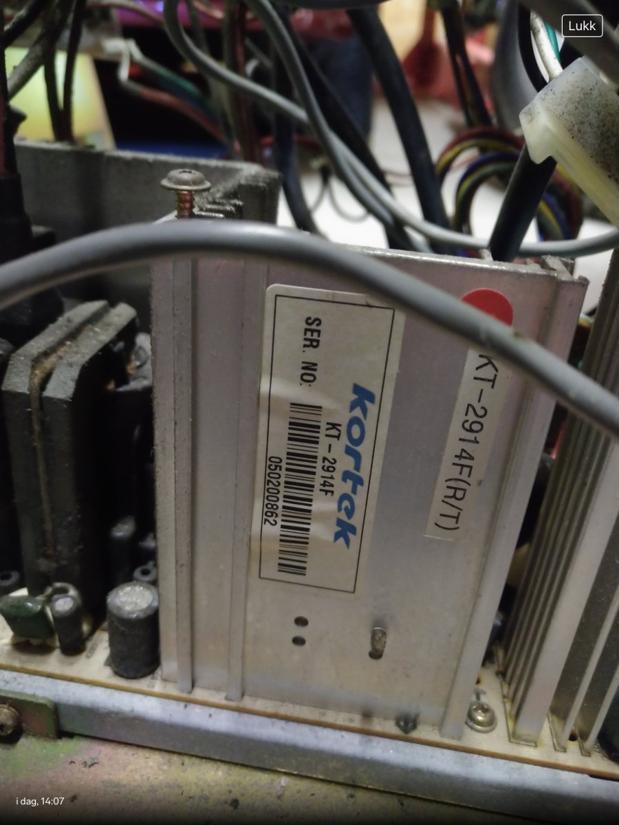

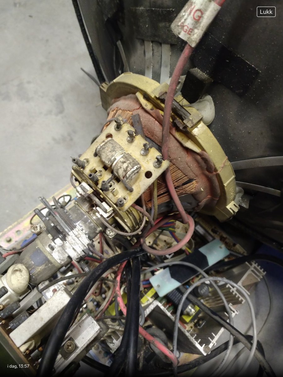

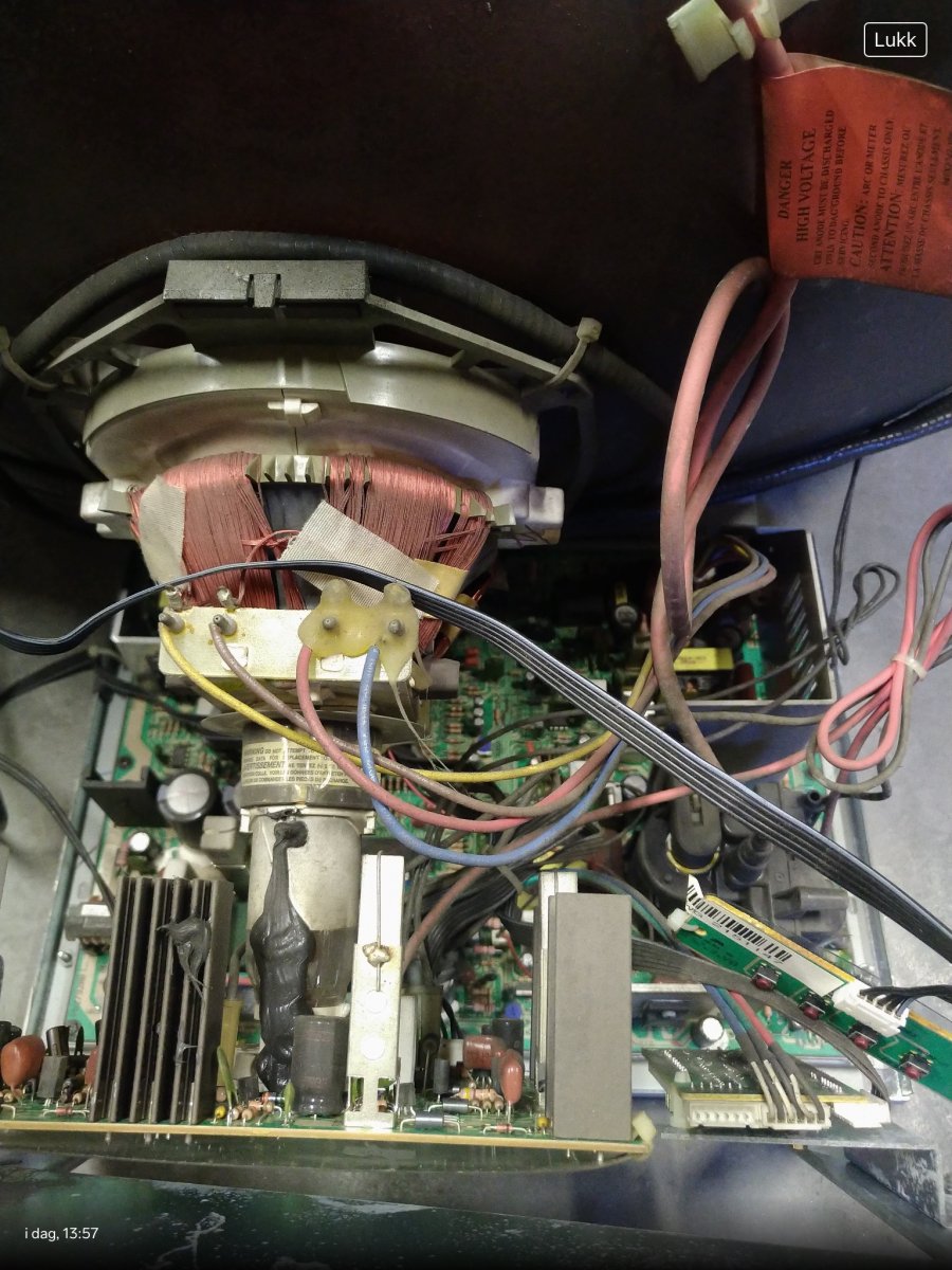

Does anybody know what kind of chassis used with these 2 monitors?
Seller did not know what kind of screens these are, but said they where used in some raw thrills cab and are from 2006.
Looking to get some backups for my NNC, so hoping these could fit.
Monitor 1
Samsung tube with a Wells Gardener chassis, but what kind of chassis?
Monitor 2
No clue...

Monitor 1 is a WG D9200 I believe.
Monitor 2 is a Kortek KT-2914F (it says it right there).

when you see a serial number like WGM2792-.... it means wells gardner monitor 27" D9200. The 4 digit code is the viewable size in inches and a code for the chassis.
