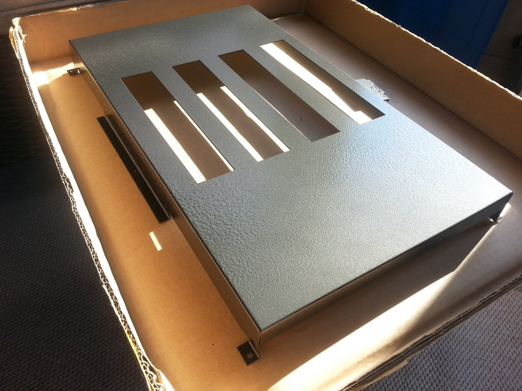

I removed the steel case's stickers with Goo-Gone and then scrubbed it down with a paste of Barkeepers Friend to get rid of the bulk of the surface rust. I then hand sanded it with a 1200-grit micro mesh pad under running water to prep it for painting.
After drying, I gave the underside several coats of enamel to stop it from rusting.

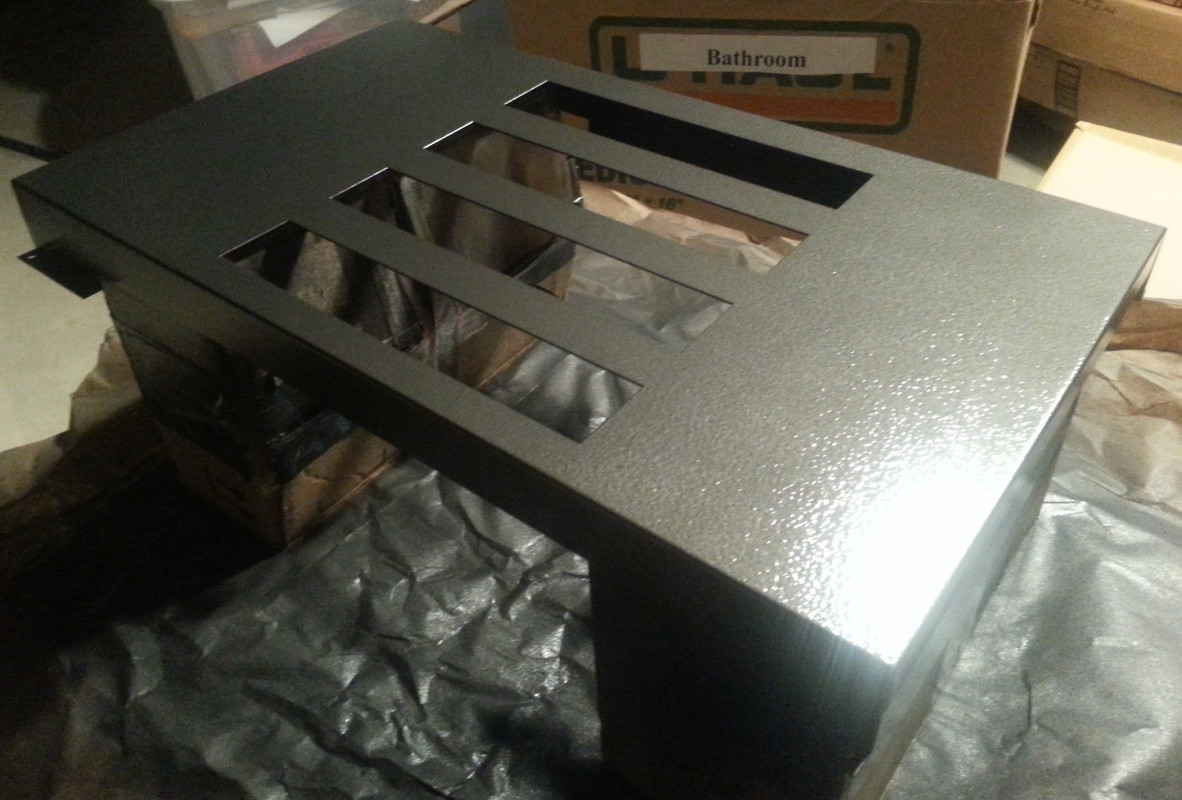

3. Paint the steel case in hammered black

I sprayed the third and fourth coats of hammered black on the shell. Now to wait a week for it to cure.

Just an fyi in case you have one of those multi carts that fit really tight. I ruined my jet black with multi clear coats shell trying to pull the cart out. It chipped up the edges on the shell slot.
Ended up taking a razor and shaving off the edges of the cart so it won't fit so tightly.

Thanks, I will definitely look out for that!
