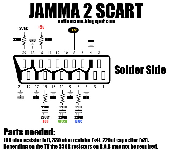

Thank you so much for your help, everyone !!!!
Lack of resistance was a problem.
Although the sound still interferes a bit with the picture sometimes but this is already a big step forward!
