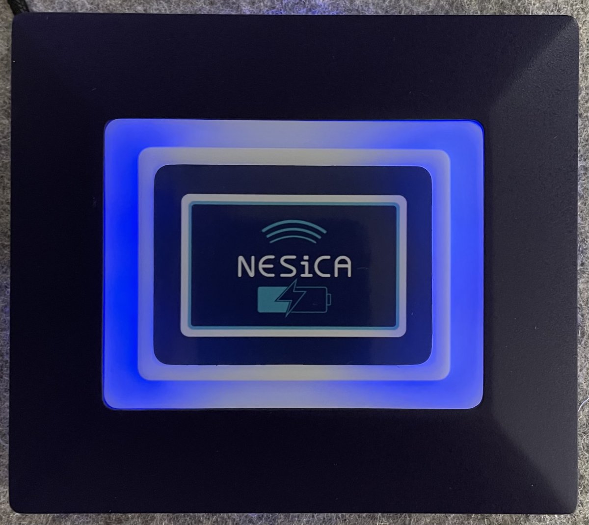

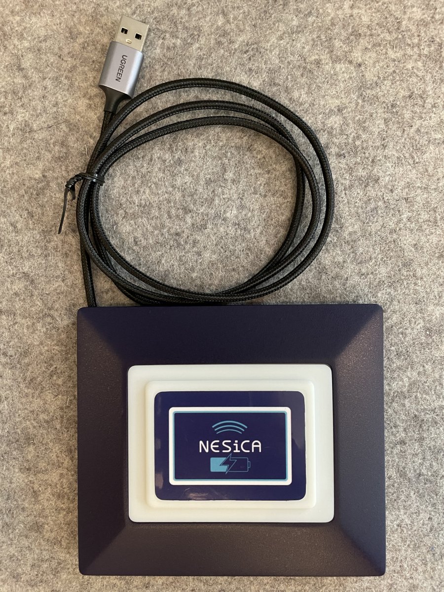

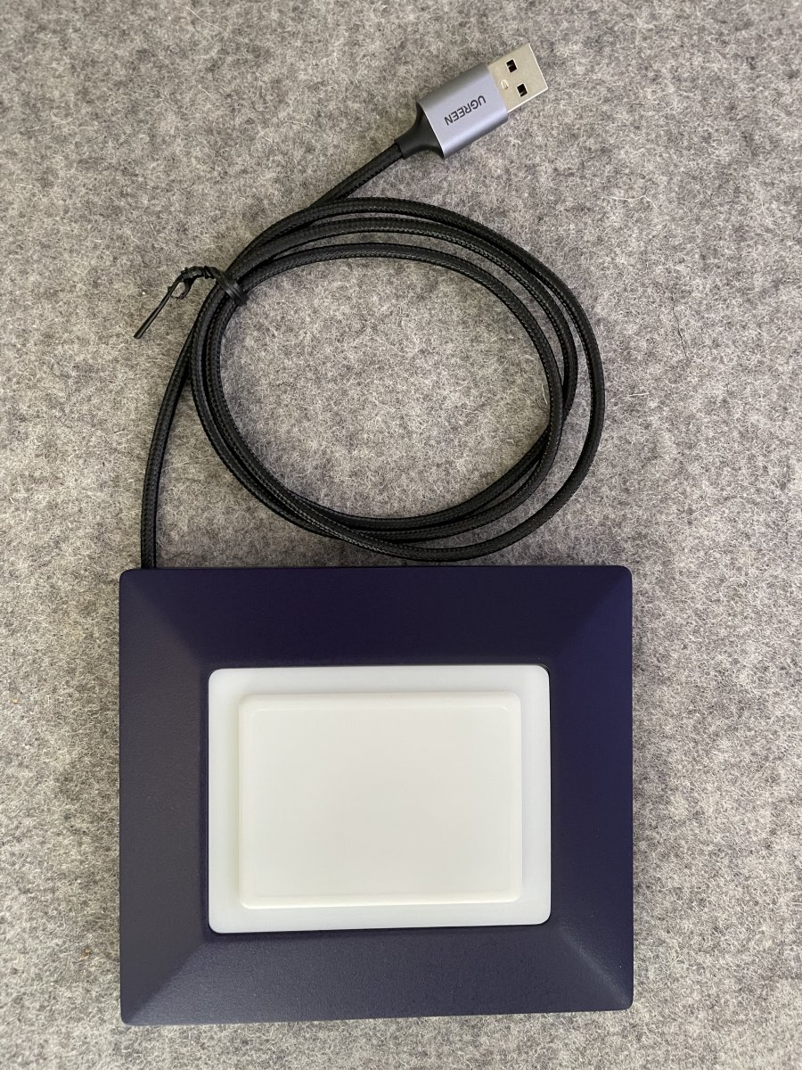

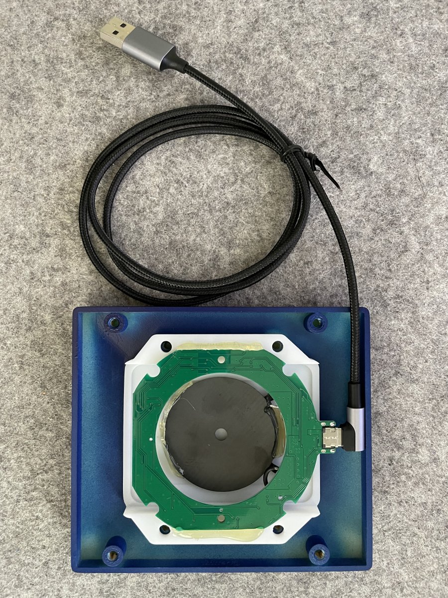

Catching up on some backlog projects. Putting one of these on my Vewlix was one on the backlog. Used a different charger, but turned out pretty solid and lights up the base pretty well. Had to add some small wire extensions to the coil board to give slack to allow it to be mounted flush. Still a tight fit for the cable, so used a 90 degree USB-C cable.

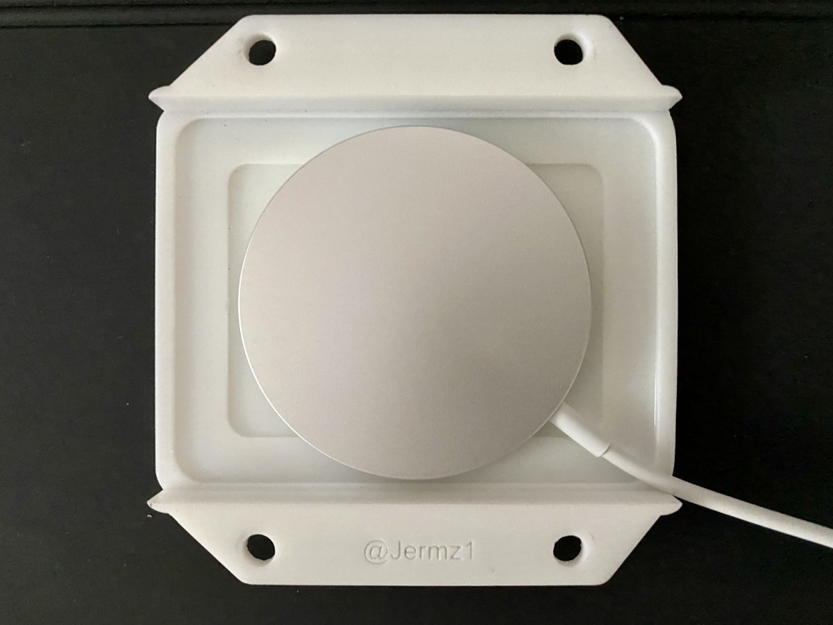

As for me, I just taped an Apple MagSafe charger under it. Works OK to (slooowly) charge my iPhone 11 but somehow not an iPhone 12. I think it may be because it sits a bit too deep.

@VxD, Yeah assume the magsafe transfer distance isn't as big/far as some of the DYI coil options. Couldn't see any details online with regards to the magsafe specs, but would assume the efficiency of the charger is dropping fast for you not having the phone directly on the magsafe.
