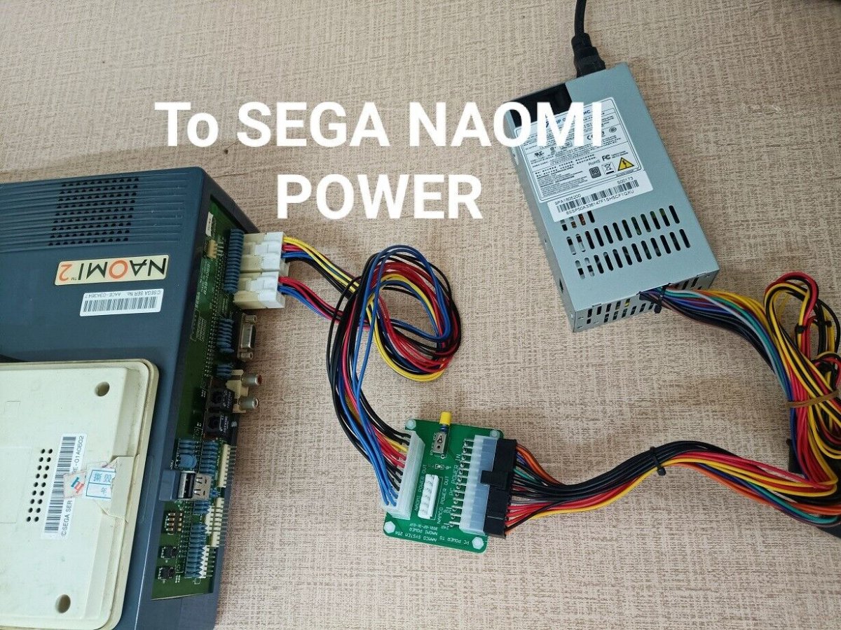

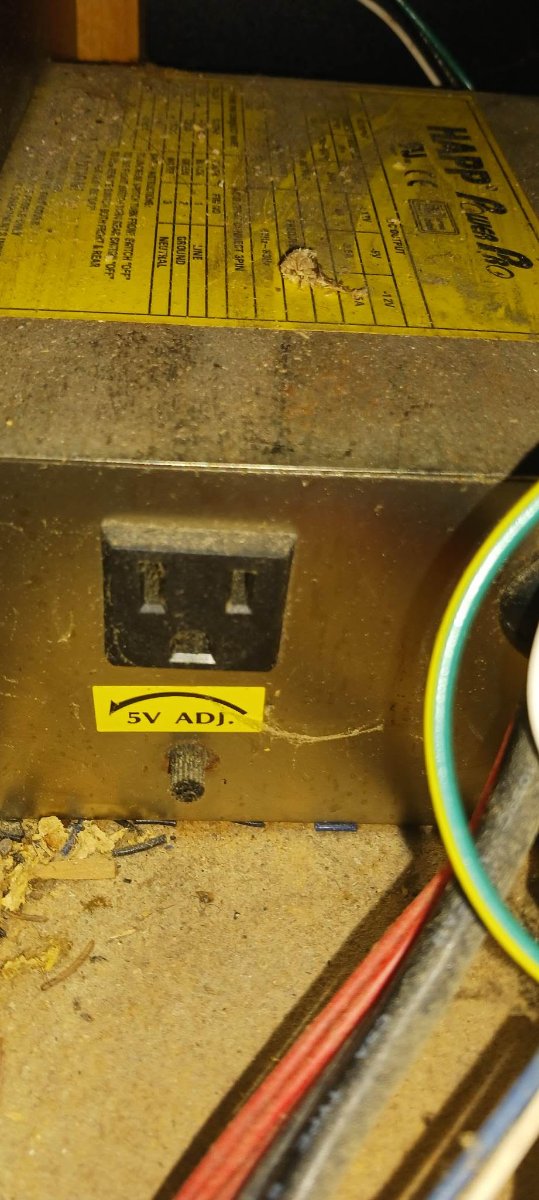

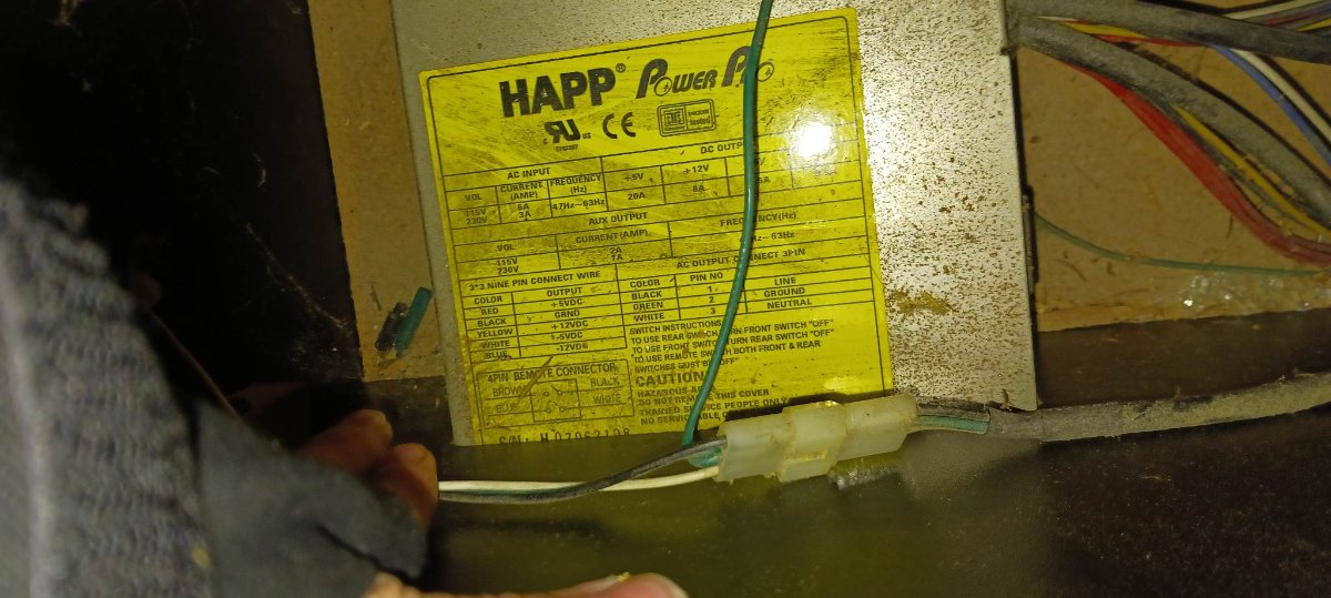

my power supply setup is a little bizarre. I use this pc power supply with an adapter that coverts to the proper voltage. I've used a multimeter on it and it comes back with the right levels. however inside the cab itself is a happ power supply. i plug the naomi power supply into the outlet on the side of the happ power supply for ac power. idk if this is what it affecting it. however I do notice when ever i take out the mother board to work on it outside of the cab it starts working better. would this be something I could fix with the turning the nob underneath the outlet?

i probably wouldn't daisy chain the two power supplies - will make troubleshooting a lot more difficult. That plug SHOULD just be hard wired to the AC power coming into the HAPP, but you never know. That HAPP might be a bit wonky, and the AC might not be steady which in turn would make the 5v, 3.3v and 12v rails not steady going into your naomi.
I would try just running your newer ATX power supply in the cabinet?
the issue is i'm kinda new to working on arcade hardware. all the wiring inside cab besides the naomi itself (jamma harness, marquee light, speakers, coin/ service buttons, montor and isolation transformer) is going through the happ power supply. i wouldn't even know where to begin with cutting and rewiring all the wires to the atx supply.
All that adapter is doing is basically just rerouting pins to the right places to have the power go to the right places. It's not technically needed but nothing should be hurting it. Since there are no passive components (capacitors, diodes, resistors, etc) on that PCB, it's just switching which wires go where to make the pinouts match up. Technically it's not needed as it looks like you already have a ATX 20 pin to JST VH for your Naomi, which should be fine (albeit it'll leave the supplemental 4 pins for ATX 24 pin, but that shouldn't affect anything).
The Happ Power Pro AC outlet is joined internally to the C13 that plugs into it to give it power, it's effectively like having the power supply plugged directly into the wall. This *theoretically* should not affect things.
The knob on the Happ power supply adjusts the +5V rail on the *Happ power supply only*; it will not change your ATX power supply's voltages. The two are effectively isolated from each other.
