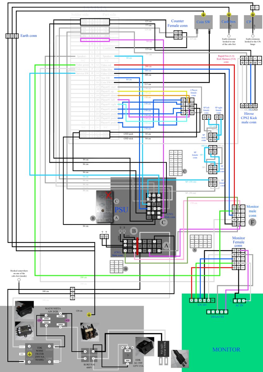

Btw, can you tell me if you see something wrong in this shema?

I've got the manual for checking the wiring but I'm not familiar with this kind of diagram/drawing yet. I'm not familiar with electronics but I'm good at finding, buying, analyzing and reproducing what I see. That's why I made my own simplified diagram. Ive observed and reproduced the original harness for this. But I guess everybody do it the same way...
I kept the harness asis so I can compare how Sega did it, but I removed some connections to make the harness more light to fit my own use. Ive removed some earth too since I'll not connect the coin mec for example and maybe other stuffs too. Also I'll add a LED instead of the neon so the wiring will be very minimal and will necessite less connections.
I notified that the Astro - compared to the Pony 18'' that' Ive refurbished the same way - does have much more earth connections, that's why Id like to be sure that my nac diagram does have the connections needed. So, please can you check my diagram and tell me if something is missing/wrong?
I'd just need a little bit of your help to shape the final step of my project concerning the wiring of a cab which seems to be a little more complex than the Pony I did before. Your help is appreciated. Thanks!
