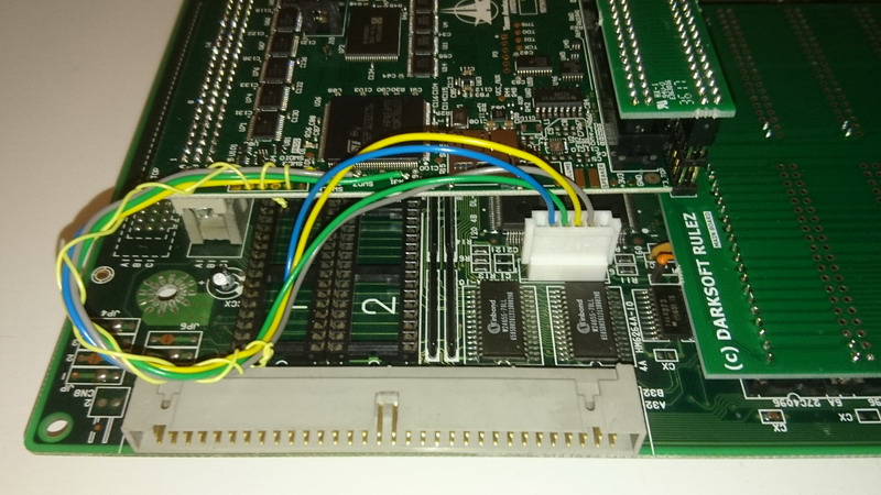

We implemented the key writing process discovered and made available thanks to http://arcadehacker.blogspot.com/

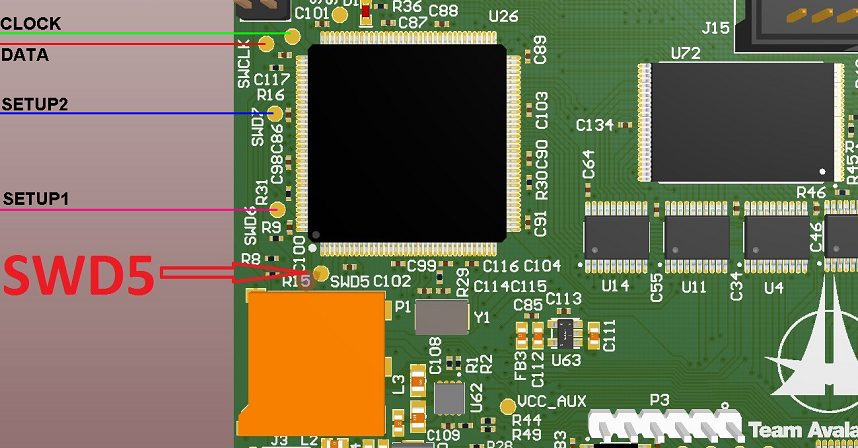

You can see a video here and a small schematics of the only 4 wires that you need to solder.
Programming of the key is done with 4 additional signals called DATA, CLOCK, SETUP1 and SETUP2.
SWD5 is not being used anymore. Now you have to use for both reset and SETUP2 (it's the same signal) the pin in SWD7.
IMPORTANT!!! Follow the instructions to connect DATA, CLOCK, SETUP1 and SETUP2 as stated here and corresponding to your version of B Board only:
You don't need to connect 5V nor GND as they are already provided by the kit.

Pinout for board revisions 93646B-3 and 93646B-4
CN2 interface pins:
DATAArduino #2→ CN2 A32
SETUP1Arduino #3→ CN2 A30
CLOCKArduino #11→ CN2 A31
SETUP2Arduino #12→ CN2 A29
Pinout for board revisions 93646B-5
CN9 interface pins:
DATAArduino #2→ CN9 #2
SETUP1Arduino #3→ CN9 #3
CLOCKArduino #11→ CN9 #4
SETUP2Arduino #12→ CN9 #5
Pinout for board revision 93646B-6, 93646B-7 and 97691A-3
CN9 pins:
DATAArduino # 2→ CN9 #2
SETUP1Arduino # 3→ CN9 #3
CLOCKArduino # 11→ CN9 #4
SETUP2Arduino # 12→ CN9 #5

WARNING!!!! DO NOT INSTALL THE WIRES UNTIL AFTER UPDATING THE FW!!!! IF THE WIRES ARE INSTALLED WHILE TRYING TO UPDATE THE FW YOU WILL CORRUPT THE BOOT-LOADER ON THE KIT AND YOU WILL HAVE TO REWRITE IT USING A DISCOVERY!!!
