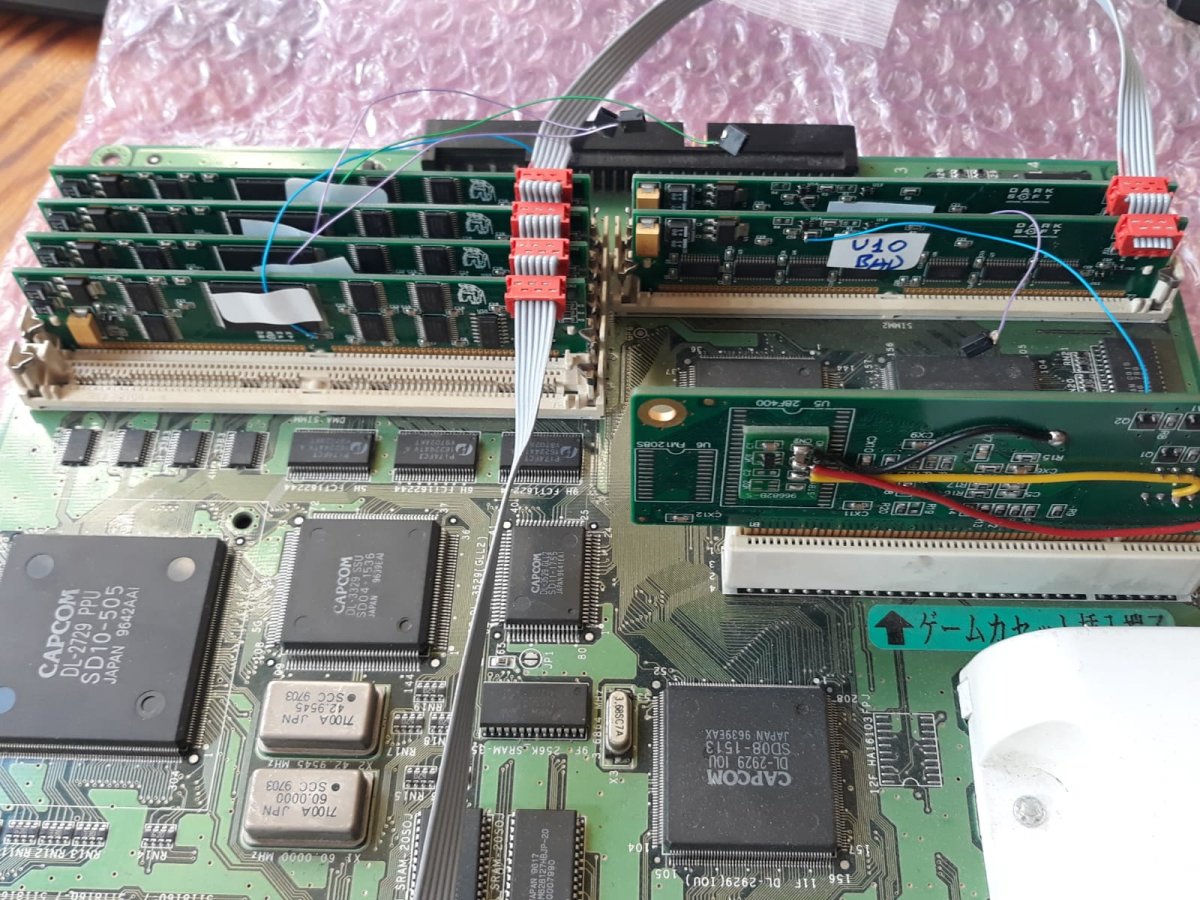

New CPSIII Ultra Simms !!! With 8x the capacity of a regular SIMM
To run a CPS-3 setup with the UltraSIMMs you require two other pieces of hardware:
• A Working CPS-3 Motherboard (doesn’t matter what region, or game)
• A UltraBIOS cart. It's basically a regular cart that has the processor replaced with a regular SH2 and has the UltraBIOS in the flash (see attached). Reproduction carts have the right SH2, so you just need to write the new file to the BIOS.
The fastest method of programming the UltraSIMMs is with a ProMan (also known as TL86Plus) programmer.
See video below:
Instructions can be downloaded HERE: https://mega.nz/file/1RUnSC7I#iw8af8UNEhUS7khpxzrew2i5YQX1LaAkbVKhcp8Ky8I

This seems awesome. If I'm understanding it right, these would replace the existing CPS3 SIMS and an updated BIOS would then allow you to instantly switch between games without having to reload, etc.? If that's correct, WOW!
Code suggestion from someone who does not know how coding work or if there is much room left. Is it possible to make make it a no cd setup but enable the cd function with a button combo?
This is more complicated than expected and requires a big rework of the BIOS code
