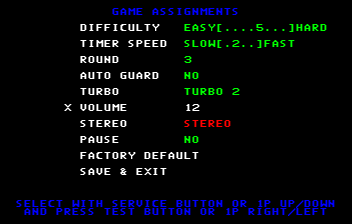

I don't see a volume adjustment in the test mode.
Well that seemed to do the trick, I moved it to the top at 15.
I didn't realize that each game has a different menu...
