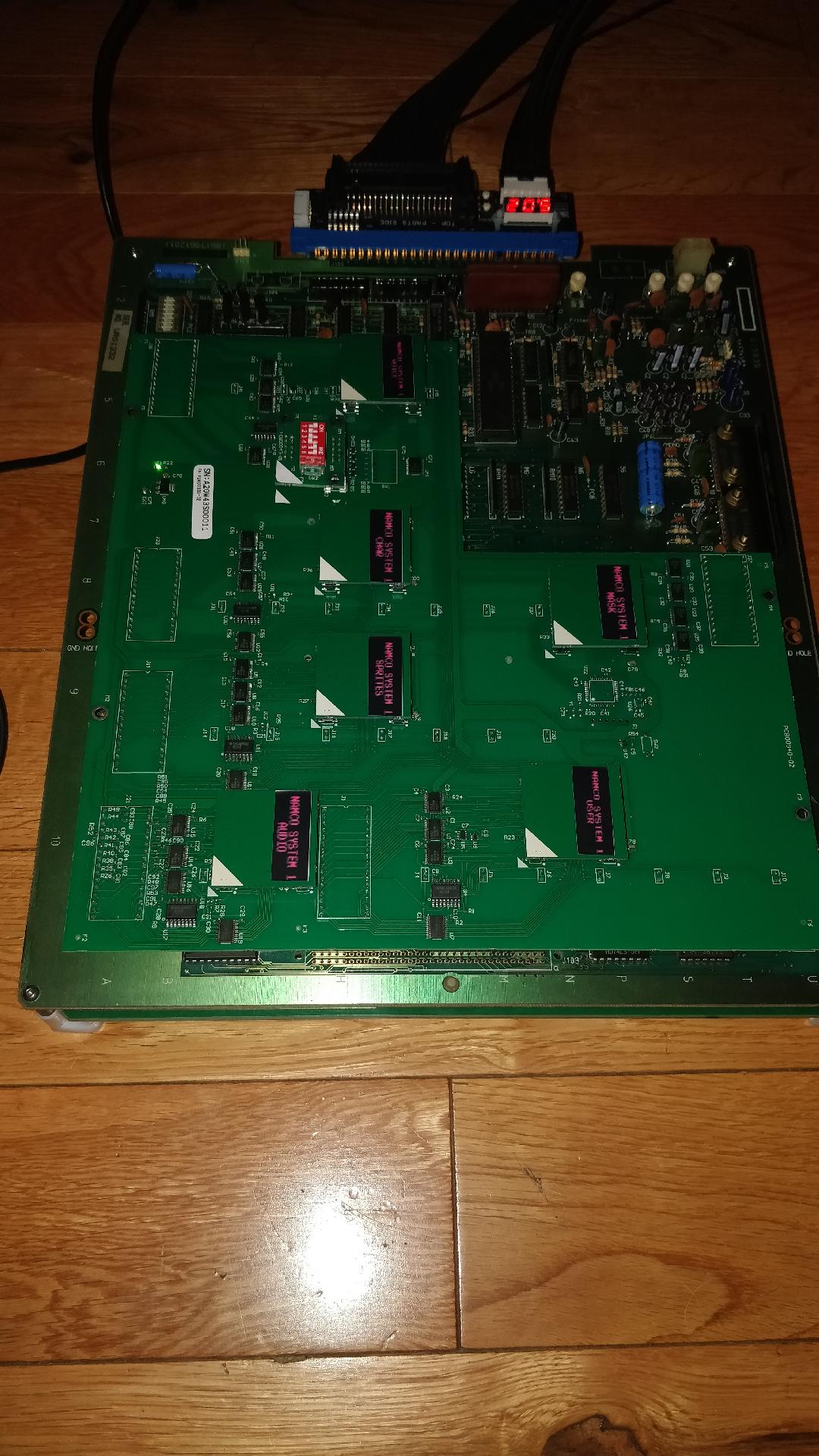

I just installed mine. No issues and booted up Splatterhouse to do a test run! I used those standoffs to help with the delicate install. Glad you asked @Psyko-M1 or I would have not known either what to do with those.
Thank you @Darksoft for yet again crushing it and @HighScoreSaves for getting this bad boy out before Thanksgiving.

Went full @GC8TECH and gave my namco system1 the gold cap treatment. I do assume it’s complete overkill to use audio grade caps on all this 8-bit audio but it still sounds way better than before I recapped it. ;)
if you have the model or the mouser part number I can add them to the capacitor list as option :)
Found them they should be UFG series from nichicon they're freaking expensive but it seems to be an even higher series, the UKZ series =O

@sk8er000 oh these aren’t that expensive. Audiophiles go nuts... don’t look up Duelund capacitors!
of course not for a signle recap I was talking about big quantities compared with other ones. I had good experience with elna audio rated capacitors too
