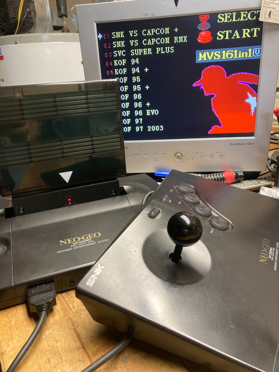

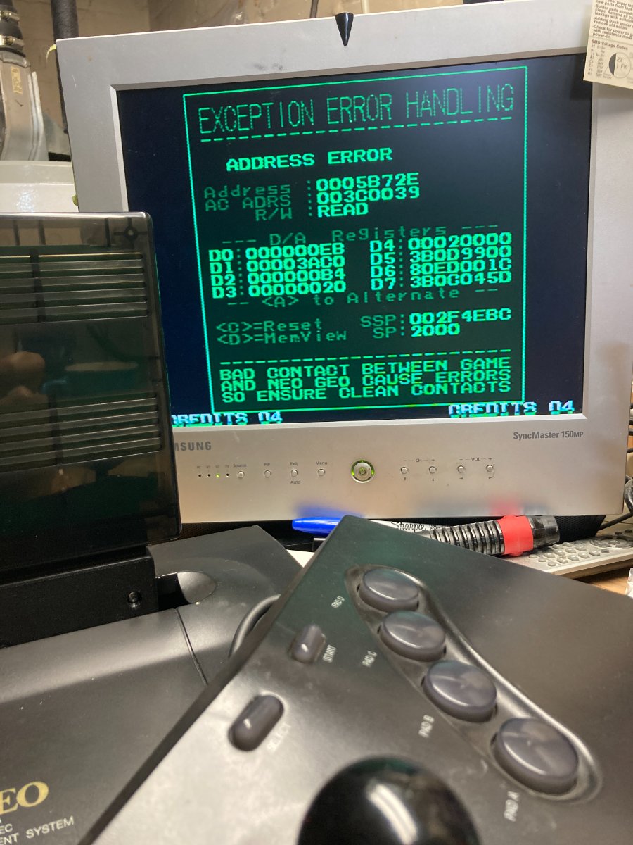

Do not buy MVS 161-in-1 carts in the hope these will just work with a Furrtek converter on your AES+. They have a design flaw that makes them only "work" on MVS. I'd be surprised if I'm not the biggest buyer of these carts in the world (300+ and counting). To work on AES, the flash memory type and FPGA code needs to be changed.
Technical reason: The 161-in-1 V2 carts switched to using a single F0095H0 flash chip to hold all the PROM data. Older carts use multiple Fujitsu 55LV100S chips. The Fujitsu flash is more tolerant to 5V. The way address/data lines are marshalled through the Furrtek adapter seem to overwhelm the F0095H0 and it provides wrong data causing the AES to crash (timing issue? who knows)
FWIW, I've also observed data corruption from the F0095H0 in the PROM position on my MVS. But it takes much longer to manifest (15+ minutes) The older V3 carts, that use 3 Fujitsu chips in the PROM position, can run for hours with no data corruption.
