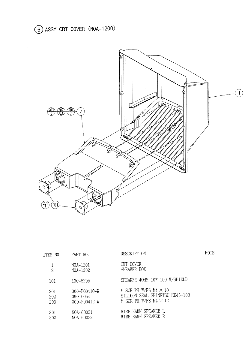

I will finish soon my NNC restoration, but I need some help for CRT cover:
- how to remove the lower part without break the little brackets on the back?
- what's exact original color ref? or whatt's best black for paint (brillant,...)?
- could you advise me a best couple of audio speaker perfect fit and perfect sound?
THX

I think when I restored my NNC I cleaned the part as a whole, don’t remember exactly if I was able to take it out.
for speakers just go to any local car audio shop and get some fitting ones.
I got speakers from Hertz, and they sound great!

Yeah, I think I tried once and I couldn't get it off. It snaps in to place IIRC.
The speakers are 100mm (4") 8 ohm. It's a very common size. I'm sure you can find a ton of options.
