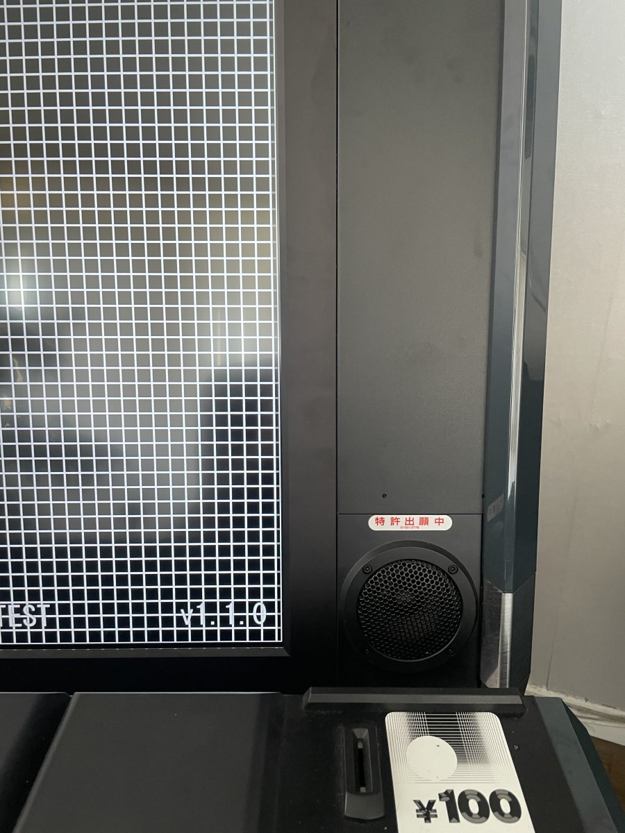

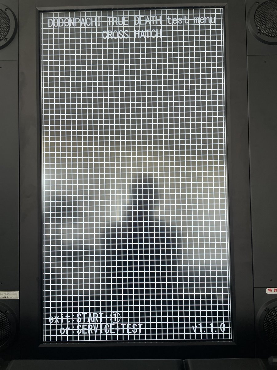

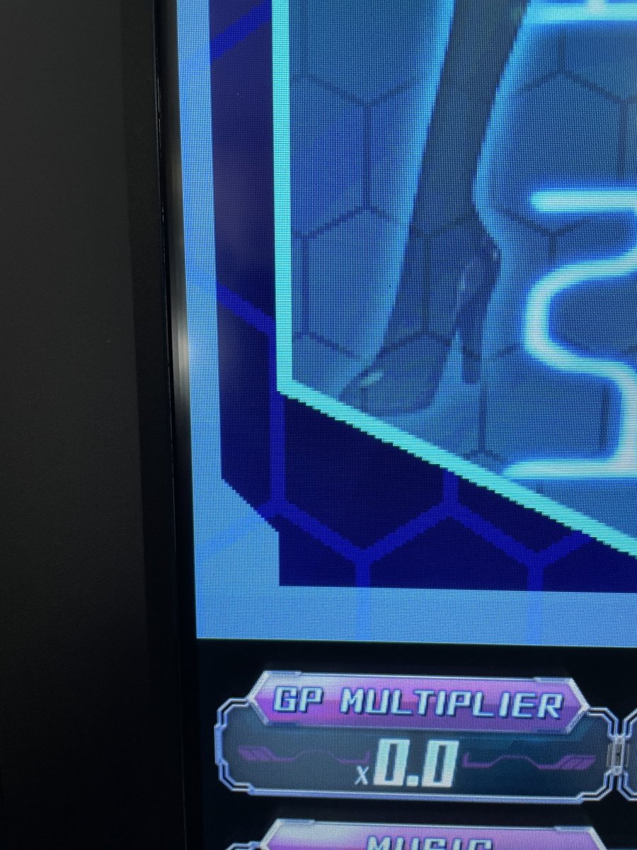

Update!basically got no where with alpha displays so not working this wknd I stripped it down,I could see the edge of the display on the pannel and relised that even if there was a screen position adjust it would still be out,so I managed to nudge it over slightly,but main thing was the bezel,none of the bezel holes lined up with the monitor!so I ended up re drilling and taping the bezel.i can only assume that because these holes were off the was pulling the monitor to the side.basically poor assembly which is a shame because the picture is so nice!just lacking that attention to detail really let them down and in no sane world should I have to make such adjustments on a brand new monitor!

Crazy you had to do that, I guess the offset was within specs for QC to pass it. Im happy you got it fixed though.
