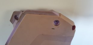

OK, so. Added some primer to the Cyber Lead panel, and to the Virtua Stick Pro. I know the former is polystyrene, but I have no idea what the latter's made of. They're both fairly thick so I'm not super worried about the effects of the primer, which should set long before it has a chance to melt the plastics.
I slapped a bunch on with a paint brush in a thicker than normal layer, just to stress test, and both plastics came through without any issue. Even at its wettest, there was no flex or deformation on either surface. So, when I get to spraying it (still need a compressor and sprayer, and some skills...) it should be fine.
Here's a photo of the Cyber Lead panel with primer, and two pics of the Astro City CP with the damage done by the previous op. I reckon the cracks below the panel were a direct result of the tension they were under and the dumbfuck introduction of a screw tip into the worst place.

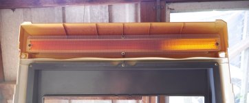

Spent some time smoothing out the NAC panel housing, and then turned my attention to the Naomi Universal. The plastic has not just turned yellow and incredibly fragile, but it's crazed with hairline cracks, and a couple of real cracks as well. The horizontal layer beneath the fluorescent light and the monitor has warped as the plastic has expanded over the years, and just bending it to see if it could be straightened made a few cracking noises. This whole piece is in desperate need of some protection.
My plan is to apply a lot of fibreglass to the inside to make it a little more durable, and then prime and paint the outside to keep the UV from making it worse. I figure the fibreglass will do the most good if I put it along the two sides and wherever I can fit it on the top. I also hope to add it to the screw holes, because they're fragile af, and one has already come off. A previous owner has tried to repair it, but it didn't work. Neither did the glue they slapped on the top corners, two spots that are definitely getting some fibreglass.
Also, the red/orange cover over the fluoro tube has crazed like crazy too. I may have to look at finding a replacement for this somehow. I'd love to put a clear one in there and use an RGB string behind it.
