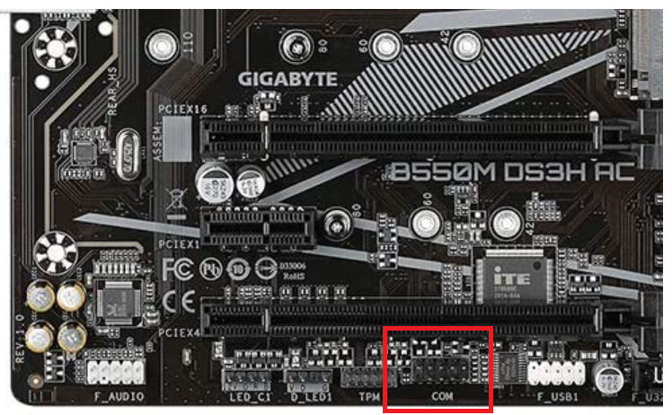

I'm looking to use this motherboard (Gigabyte DS3H) with an original Taito JVS PC card.
As the above motherboard has a real COM1 port, I believe just connected this up and using Niko's tool should work?

I understand I'm bumping a old thread now...
But I was hoping someone could help me out with this question.

Yep, just make sure you're specify the correct COM port.
For maximum compatibility you can change it to COM2.
