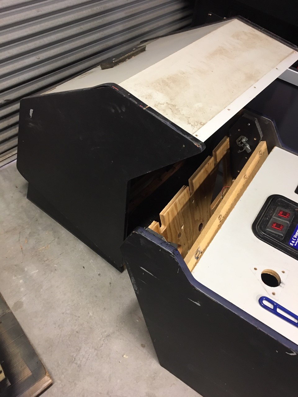

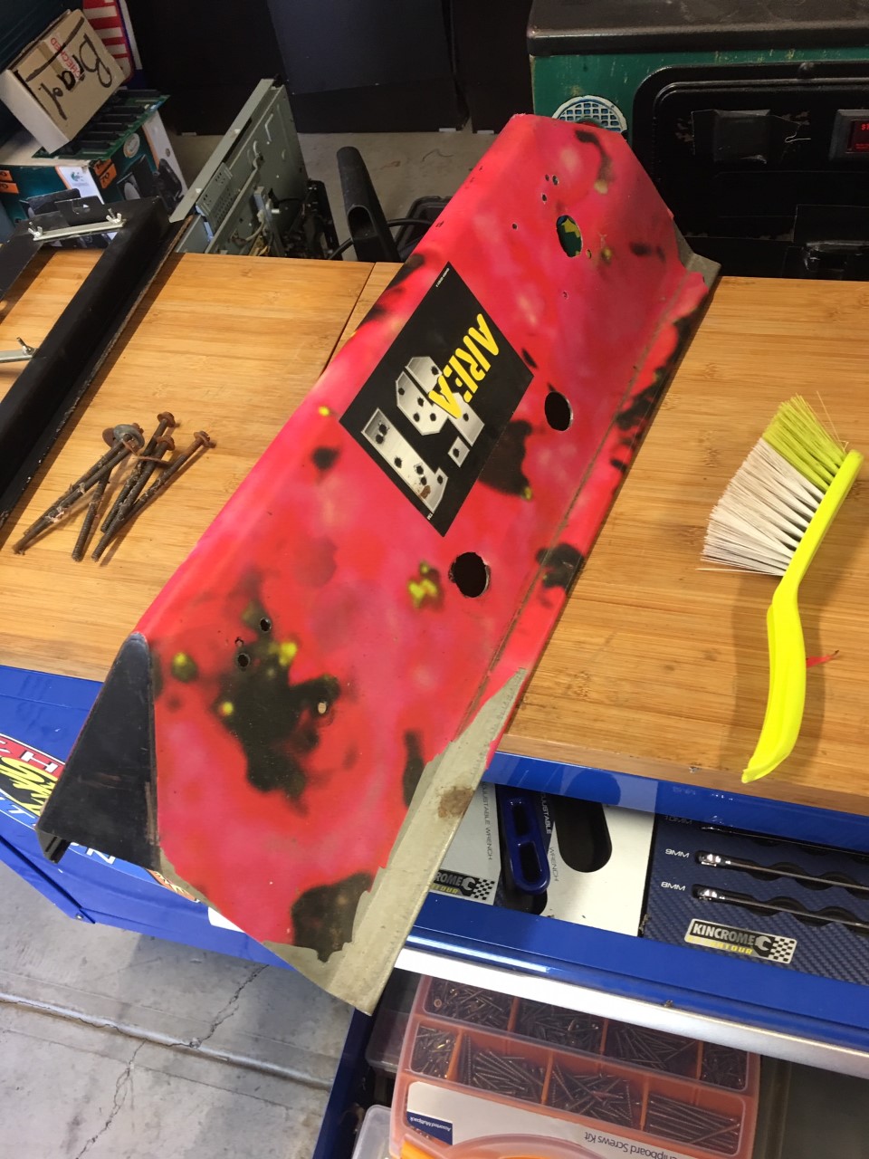

so i started to pull down the cab, it actully comes apart in three pieces which is awesome cause this bad boy is super heavy.
Out came the Glass, monitor bezel, CRT Tube (Phillips) and chassis WG K7000 and then the mini marquee holder and top speaker shroud with header insert
They will be sandblasted and restored in hammertone like original.
There is a massive steel foot rest at the base that weighs a fair bit and was a night mare to pull off
This will be sand blasted then powdercoated black again for years of use ahead
This thing is honestly so heavy ive put some heavy duty castor wheels on it so i can move it around without doing my back in.
Here is the mini marquee holder and header and speaker shroud.
running some smooth JBL speakers these are great ill keep these
Mini Marquee holder with all pins and brackets in tact. have ordered new perspex for holder cards and copied worn out original will look brand new again.

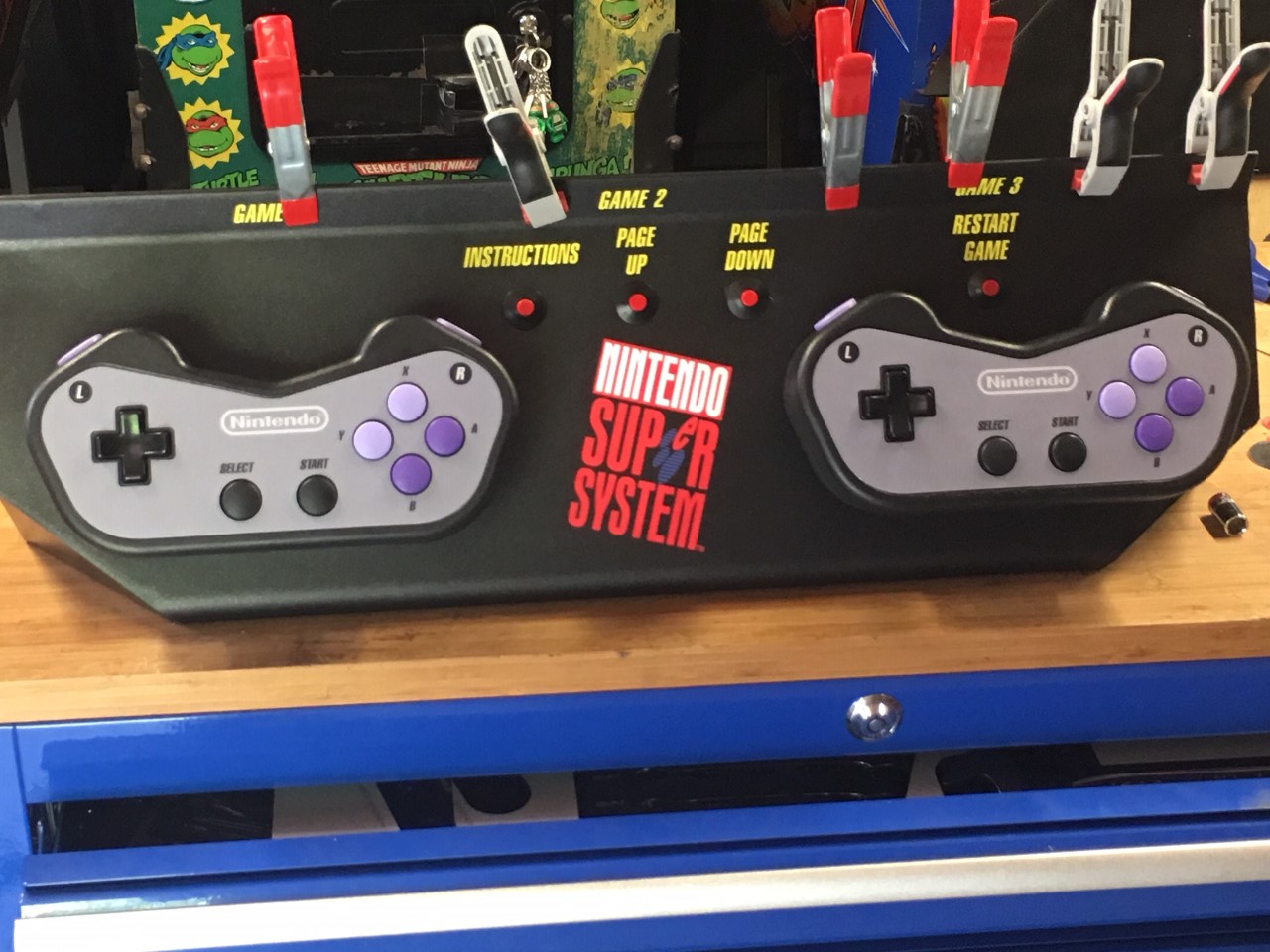

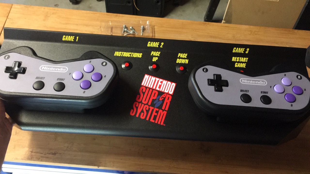

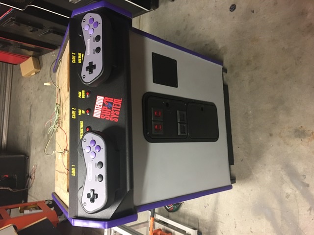

Next was the control pannel
This wasnt to hard to remove heat gun and she all came off. then sanded and primed in black paint ready for the new overlay.
New overlay installed
now to find some controllers to suit
i had 4 different ones so id make the best pair out of the four
took apart and made the best set cleaned and adjusted all microswitches and perfection
Now its time to do the body and artwork next ill keep everyone updated

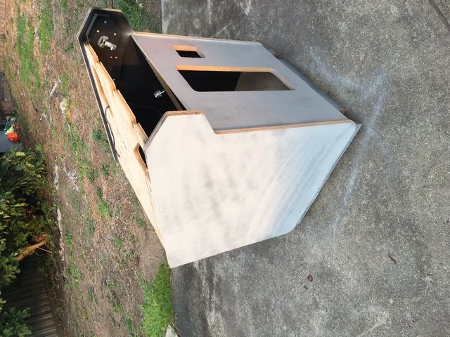

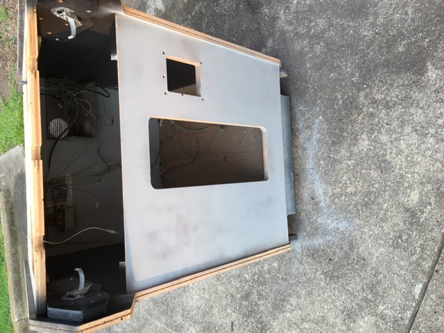

Some more progress today.....

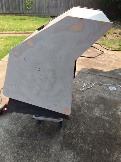

started pulling apart the base and sanding
as i found once i started that there was several layers of paint over the years this thing has been coated :)
original grey paint...then blue...then red and finally black so four coats
its chewing through the sanding discs
looking good now.... ready for paint first remove the coin door and fill the gun holes in the front..
Stay tuned

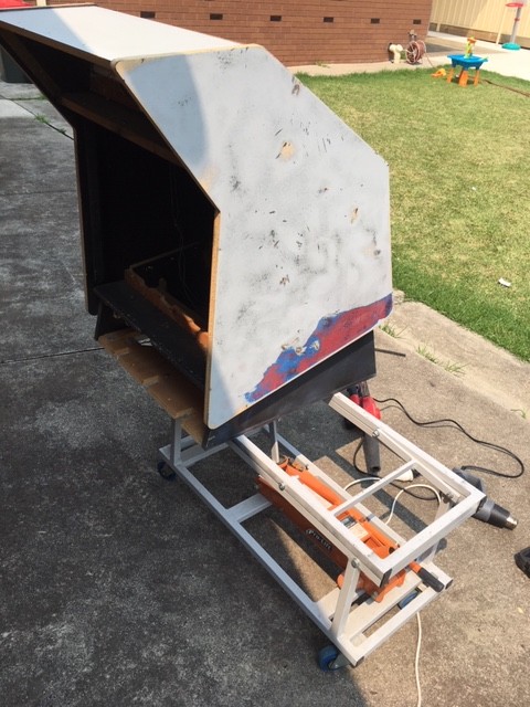

Hey guys,
Been crazy busy over the xmas period so back at it now....
I managed to got the top half sanded back and ready for side art. The cab still has its original Nintendo ID tags too which is sweet i will be able to save them.

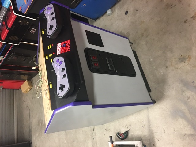

got the base completely done now
Base sanded and primed now painted
New t moulding installed and pcb and new meanwell psu also. Control panel added and bam she’s half done lol

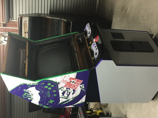

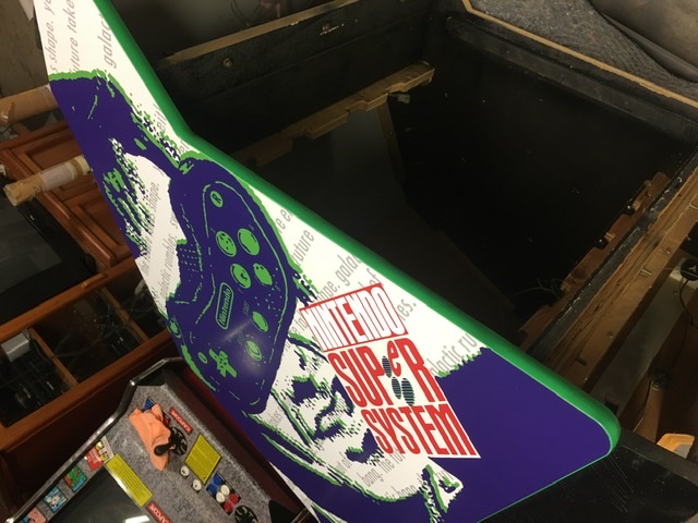

Some more updates guys.......did the top part of the cabinet and put new artwork and T Moulding on.
This thing is coming up awesome, I really dig the green T Mould on the top
What do you guys think?

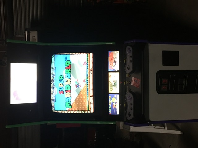

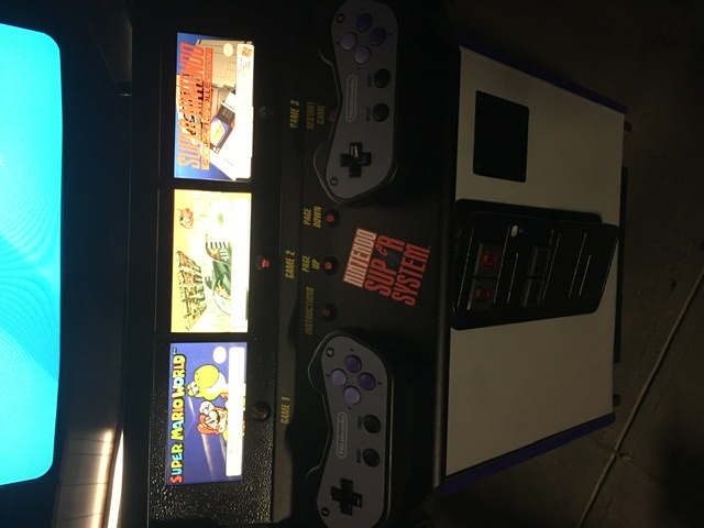

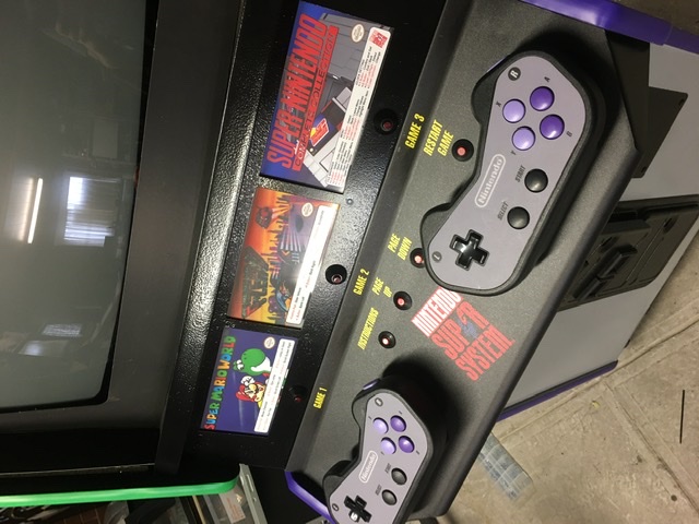

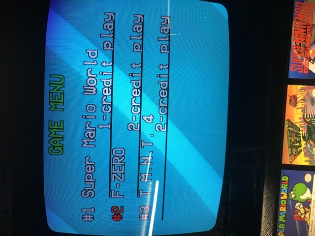

Finished it today everything is back together running perfect
