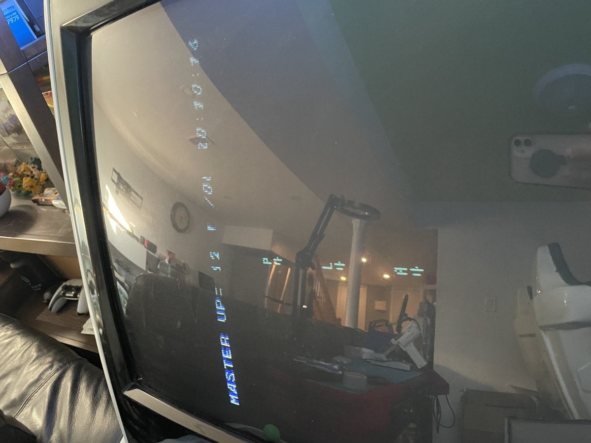

Got the roms burnt and one board comes up with the beginning screen showing the date and master version , then resets over and over.
The second one comes up as a white screen with some purple lines
