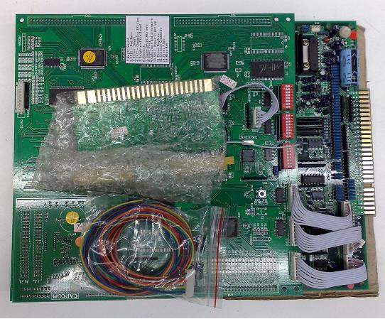

Has anyone seen that old CPS1 14 in 1 board that used to be floating around? It had a mix of normal and bootleg ROMs on it. Probably the only thing making that one no good is that they didn't know how to do the ROM work to make them all work on the same C board.
Edit: this thing http://www.happmart.com/Pro_Details.aspx?id=833&px=0&sid=89
That thing on the photo is not even a CPS1 hardware. Seems to be a CPS2 A Board + custom B board
If that is the case, finding the related 14 game ROMs for that specific hardware may solve the multi cps1 problem all together? I mean, just put "those" ROMs on CPS2 multi and problem solved? :)
That 14-in-1 is not dumped. I don't think anyone who has owned it is equipped to dump the SOP44 roms.
I think the "Phoenix" in the game list is some hack of Super Pang or something? That's the only reason I ever wanted that thing.
Sorry this is the one I was thinking of: http://www.gamedude.com.au/arcade/
Definitely based off cps1
Edit
@Mr T Guru has a 14-in-1 (it's even for sale in his sale thread) and I'd bet sop44's are no problem for him. I dunno why it wouldn't be dumped if he has it - maybe nothing original is on it?
