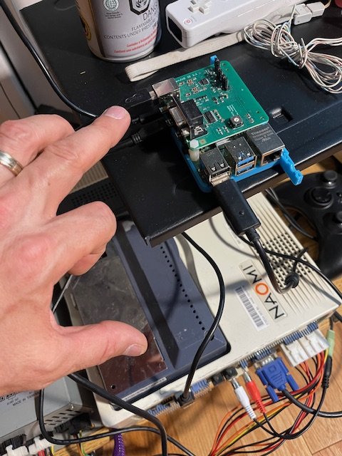

Is this the cable that you’re looking for? It’s a USB-A to USB-B cable and can be found at most electronics stores.
TOPS sells the original cable for Naomi.

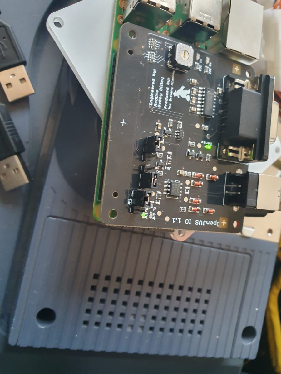

Thanks for the reply, I would like to understand where I'm wrong.
So I did a new installation of the SD by downloading Wipi. I updated to the latest version, connected the Noami and everything works perfectly.
He sees my controllers and lets me set them up.
I put the jumpers as in the photo but it doesn't work but I also tried all of them on the right
I always get board error.
I start crazy taxi but nothing works, no commands work.
I would like to understand where I'm wrong, thanks

You appear to be almost there! :)
So you have a rasberry pi 3 if you tried them all on the right correct? if so put them ALL of the right.
Can you show us your connections?
the square on the hat goes to the JVS on the naomi right? and the controller to the pi USB?
Where do you see the "board error"? Can you post a picture please?

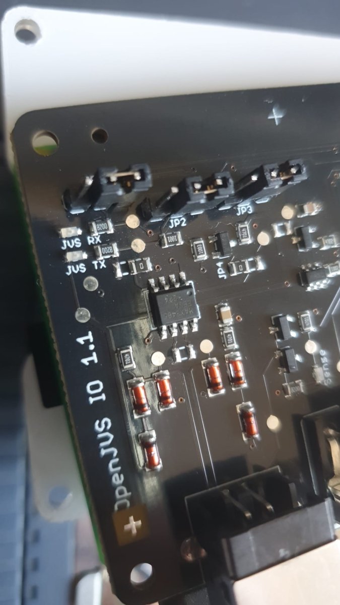

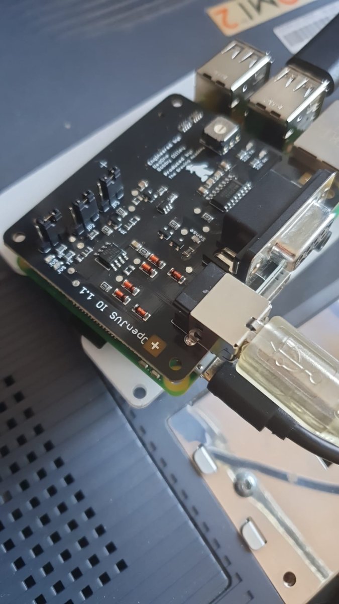

thanks for the reply, I'll start by saying that the old USB modification has always worked for me, the cable broke and I wanted this solution which seems more solid to me
With the jumpers placed in this way the SENSE lead lights up the problem that during the boot of the games the RX does not light up and I always have a board error.
I installed the latest version wipi 6.9 from code I removed bluetouth.
I can see the controllers but I can't understand where the problem could be, thanks

1- is the usb wire properly connected to the naomi? sorry I don't see it yet! So I'm going to assume it's not plugged in ! :D
2- is that usb wire is properly connected, is it a good cable? can you try another one?

yes of course I tried 6 cables, some new ones but I always have a board error, what could it be?
I repeat, I already had the modification working and with this hat it doesn't work
