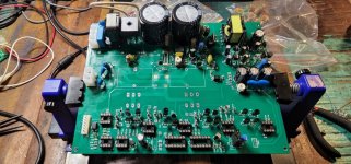

Below are some pictures of the initial prototype that I have made.
Motor Power Supplies and Controllers (MMT-4Q)
Control Box and LED
Total Setup
